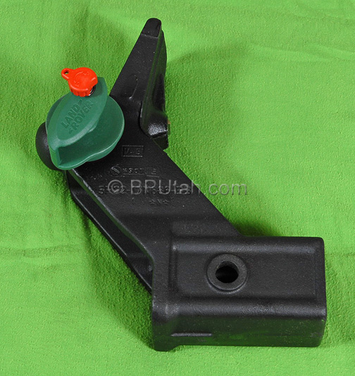

Did it have "Gen 4" stamped on it? (How did you know it was Gen 4?)
Actually its Gen 3 sorry...
This is the 2nd Gen that came with RR and LR3 -

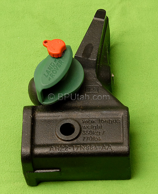

This is the new 3rd Gen that was released some time after the initial LR4 -
The 3rd Gen has 770lbs tongue stamped on it.
