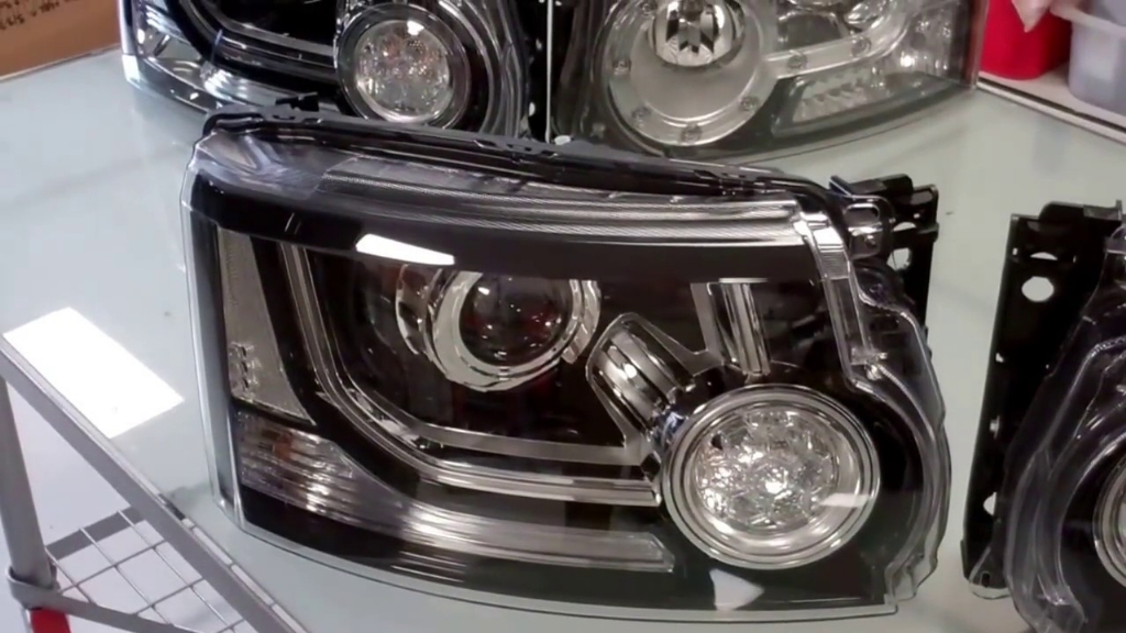

upgrade to the LHD EU/ROW headlights while you're at it.
mshale
Sep 2, 2018
59
26
Alabama
Have you got part numbers or a place to purchase by any chance? I’ve contacted PowerfulUK, but they only sell the RHD units.
eBay has tons of different part numbers and it’s quite confusing.

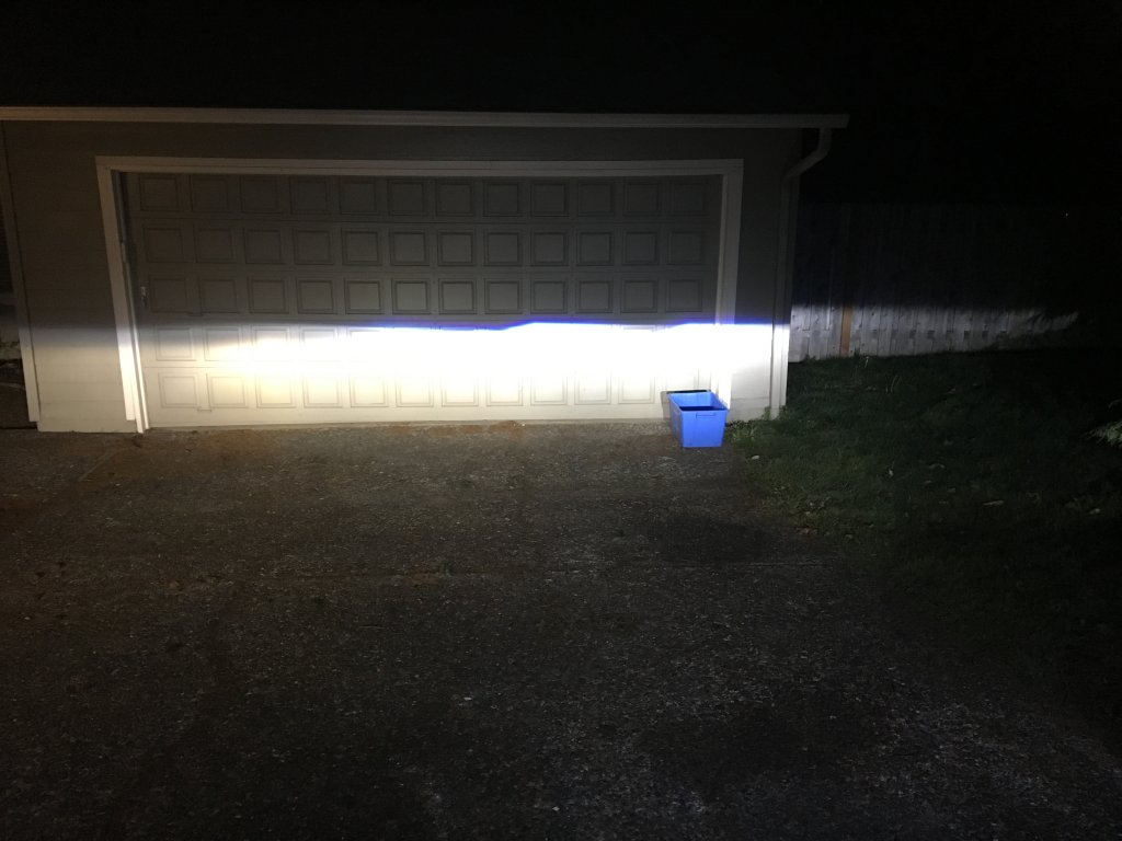

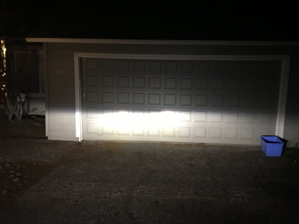

I had an LR3 with HID’s before my LR4. LR3’s have Bosch Projectors which are far better than the Valeo HID Projectors that the LR4’s come with. In the HID world, Valeo is pretty much considered bottom of the barrel, and are commonly used in a lot of vehicles...including Tesla & Chevy. My wife also has an Evoque with HID’s. I’m not 100% certain that they are Valeo’s, but a quick google search seems to indicate they are.
Here’s my wife’s Evoque HID’s and my LR4 HID retro against our garage at 25’. I’ll let you guess which is which...
Finally an explanation on why I am not going nuts. I always thought my HIDs in the LR3 were much better than the HIDS in my LR4. Now I know!

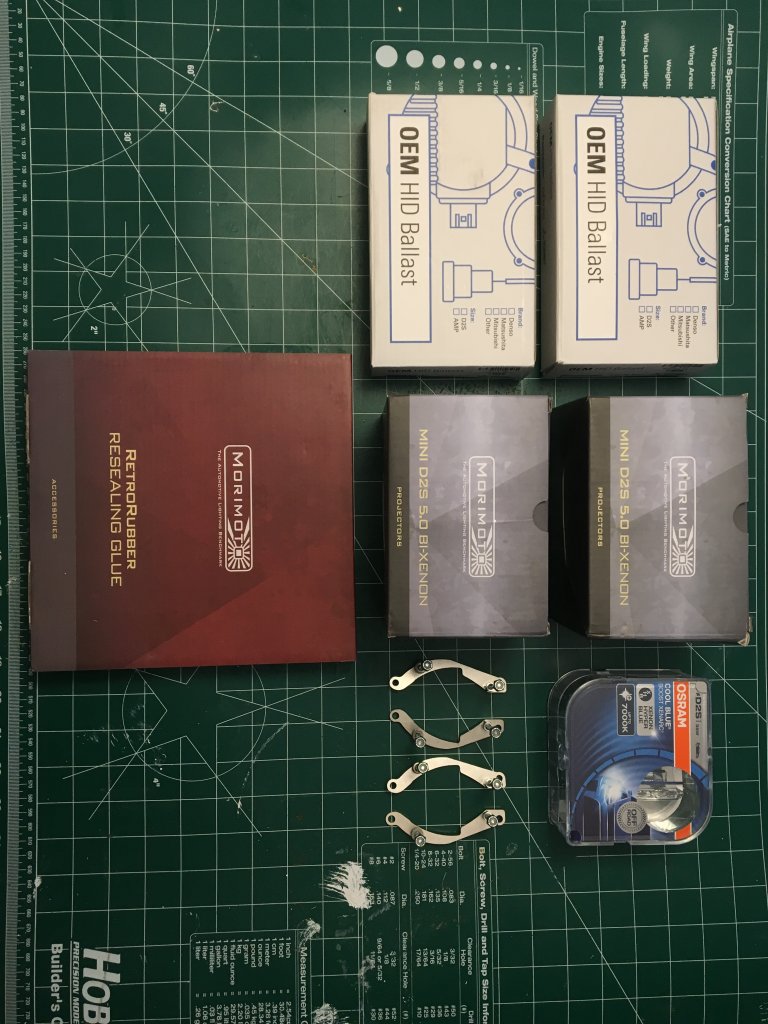

When I bought my HID housings and took out my halogen ones, I upgraded the xenon bulbs to Philips D3S 42403 from the OEM Osram 66340 bulbs. The Phillips are purportedly brighter but it could just be a marketing gimmick; I can't find the specs right now to compare the two. I switched out the bulbs before I ever used the stock Osram bulbs, so I cannot compare, but I'm pretty happy with how they are now.
I can't speak for Saltyfly, but normally changing out the projectors involves putting the headlight housings in an oven to soften the glue so that you can separate the clear front of the headlight housing from the rest of the headlight body. That alone probably keeps out the squeemish (and those whose wives aren't out of town).
