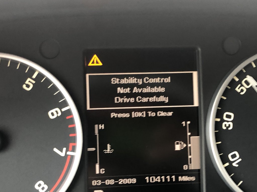

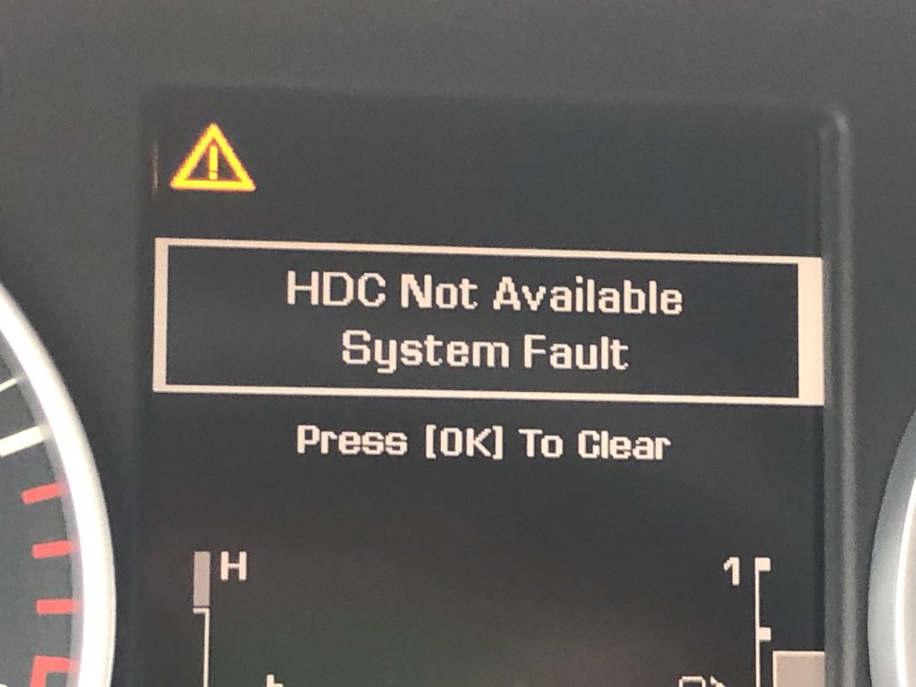

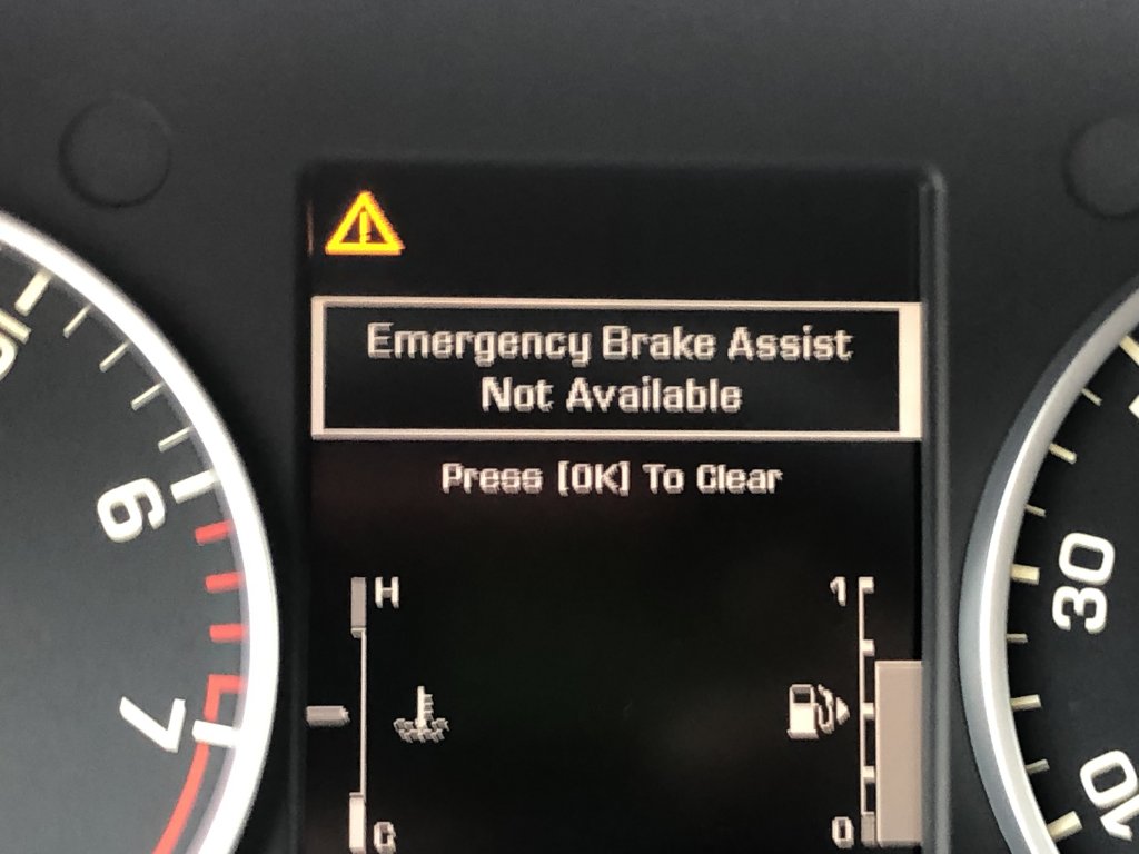

Attached are 4 images.
Any and all constructive feedback is appreciated.
I don’t know what they mean. Mechanic said I should be okay for now. Yes it is something to fix, but not something that puts me in any kind of immediate danger.
Says i’m okay to drive without worry or any major failure (or danger in road) due to this.
anyone disagree?

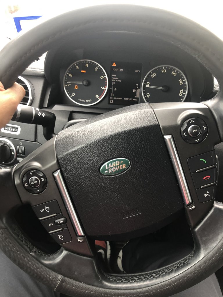

Also pictured is my steering wheel. Apparently the “toe angle” is off (whatever that means) which is causing my steering wheel to be crooked when my car is driving straight. Again, any and all constructive feedback is appreciated.
1,403
Your wheel is way off. Did you slam a curb or something?

Nope. Possibly the tow truck last week did something to it when it took my car from one shop to another.

My 2016 LR4 likes to give me the same warnings on occasion, however when I then stop, turn the car off, and start over and drive about 20 feet, the warnings go away and may stay gone for weeks? No codes are stored. Shop says: we can't fix what's not broke!

Did those codes show up after you got the tow from one shop to another? Is this when the steering wheel went wonky? Steering wheels off center can be suspension issues or not getting centered during an alignment.
1,860
Dude. If you received a car back with the steering wheel off center like that, you need to have whoever did it fix it. That could be causing some of the problems.
