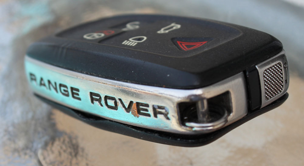

Although from a 2010 Range Rover / Sport, and so has additional lettering, I am sure many earlier Discovery 4 owners also have these rather large and heavy Key fobs that are prone to looking very shabby when the rubber starts to ripple & peel off around the edges.

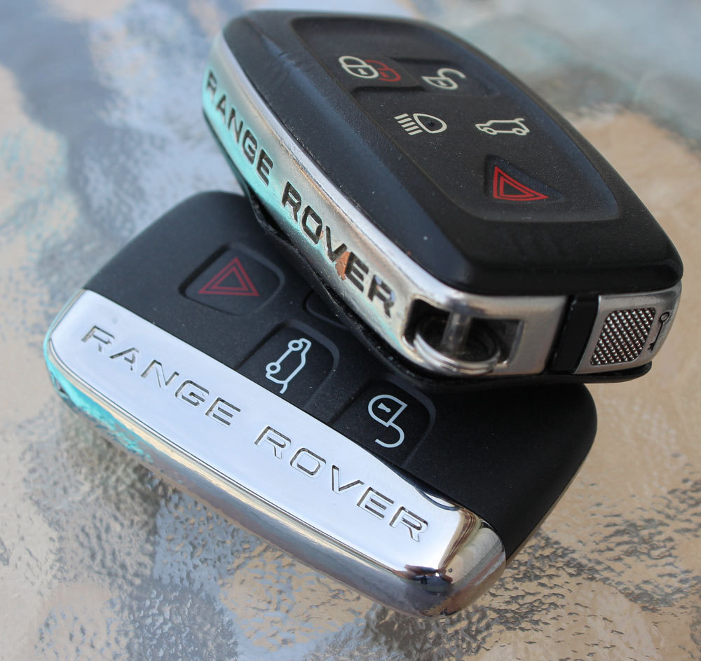

Although this would be a great improvement, I would still have some quite scruffy metal parts and a large heavy fob and what I would really like to have for my vehicle is the later, smaller, lighter and smoother pebble shaped fob.

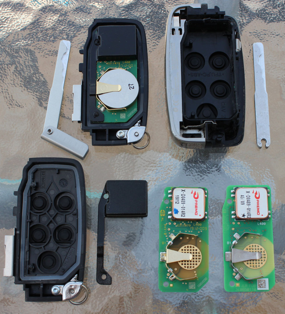

I had already purchased a number of these later fobs brand new from Ebay and so decided to open both types up.
On the new type there are a couple of small melted plastic pegs holding the PCB and a plastic cover that can be shaved around and give way pretty easily and on the old Type to the Right the PCB just lifts out.
I have also included the Key Blades for the fobs on this picture to show you how they are different. Basically for leverage the older type clips to the key body and the newer has its own little flip out handle.

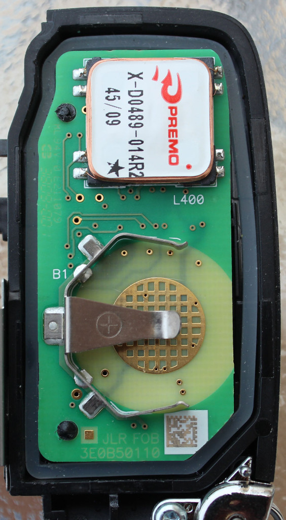

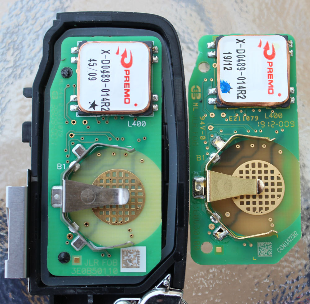

Amazingly as you can see in the picture the PCB's from each fob type are near identical with just a little size difference on the top right and bottom right corners.
On inspecting the other half of the case I discovered that the top right actually fitted and only a very small amount was required to be removed on the lower right.
However with their being no tracks I filed them both down more than enough
I had left enough on my posts to clip the plastic cover on but could have used a couple of dabs of glue. Then I re fitted the Battery, clipped the cases back together and re assembled the key blade and slide cover.
Those with an eagle eye will note on the picture showing the Key Blades that they are both cut the same to suit my locks.
