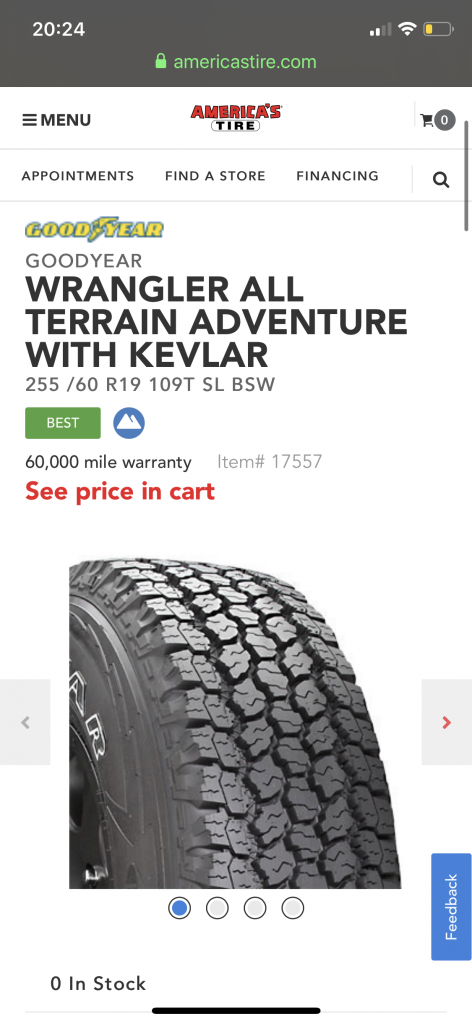

Here’s a picture

I wouldn't run those. Sidewall is weaker than factory tires.
