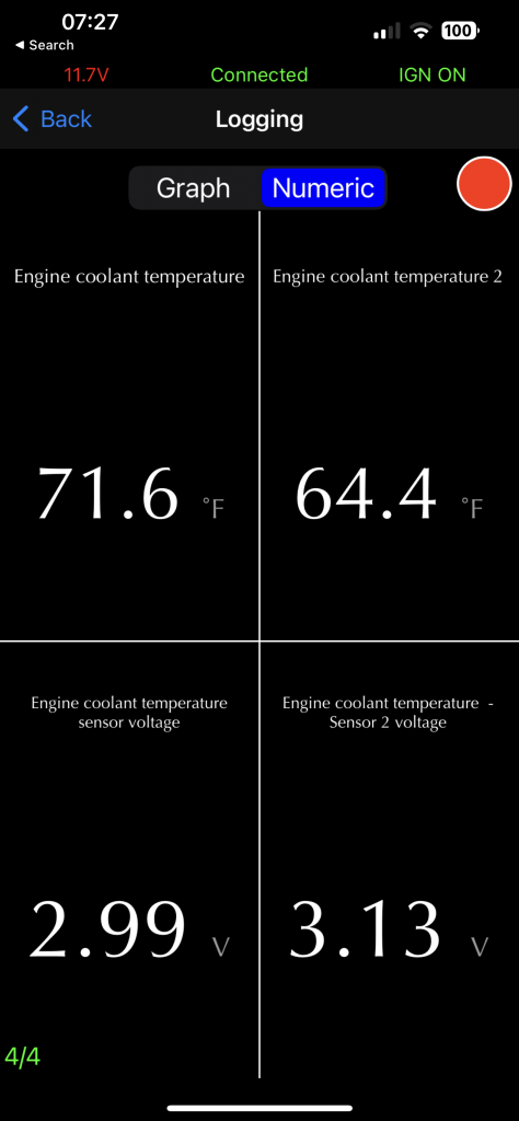

As the coolant heats up, temp sensor 1 will trend towards 0.5 volts. Temp sensor 2 will stay cooler (higher volts) because that‘s the cold side coming out of the radiator. So the general trend looks okay. Right after starting, you’re already putting some heat into the system, which might explain why sensor 1 is lower than sensor 2. I’d check them dead cold before starting just to make sure they’re about the same, since that’s when you are having an issue. If they are about the same, I think you can rule out the temp sensors.
I did that today, car sat for 10ish hours there was around a 6ish degree change. Although it’s off would 6 degrees really affect how fast a cold start turns over though? Also on the morning that photo was taken the car cranked for like 6 seconds.

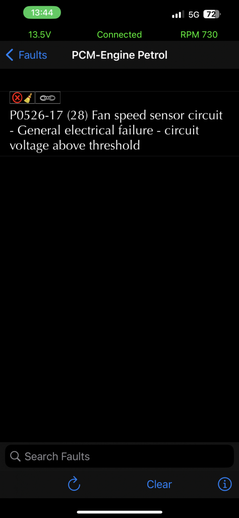

Still not completely sure what’s going on with the car, the only other thing that I could think of that I know is off about the engine is this slight exhaust leak from the manifold. At first it will make a faint ticking and puffing sound as it high idols but usually will go away by the end of the high idol then I never hear it, not sure if that could be the reason it doesn’t turn over as fast but it’s also had that leak for almost 2 years and I’ve never had an issue till now. I’ll link a YouTube video of the car cranking just to make sure you guys think my stater sounds healthy. Really stumped for this issue otherwise though. The only code I’ve gotten for the engine is P0526-17 (28). Take a look and let me know what you guys think

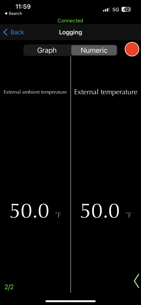

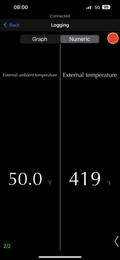

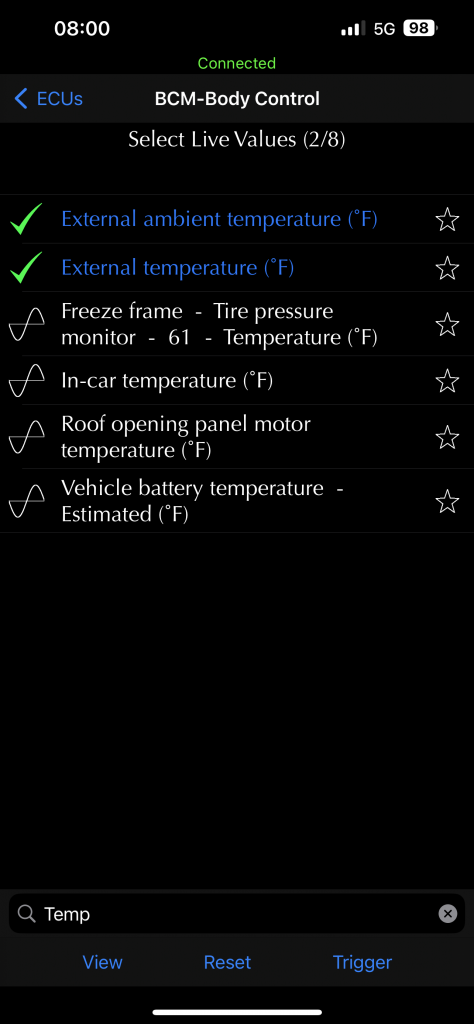

Did some digging around couldn’t find anything in the PCM temp sensors that seemed off. However I found a sensor reading 419° F in the BCM. I had an Ambient temp sensor right next to it reading the actual temp and the “external temperature” reading 419° F. Could someone check this live value in their car and make sure it’s not normal. Anyone know where this external temp sensor would be located?

The odd thing is that my car displays the proper temp on the dash so I don’t think the bumper sensor is the culprit. Is there another location for another sensor? I also did check this with the ignition off after driving so I’ll check again before I start the car with the ignition on just to confirm that it is reading a completely absurd number like 419° F.
