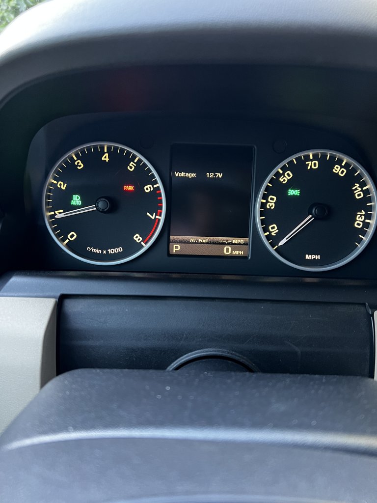

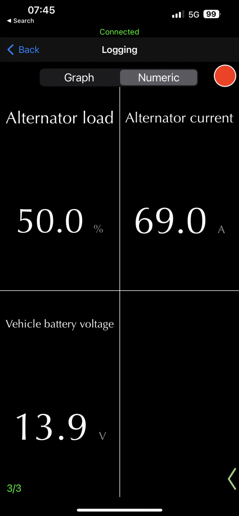

voltags did another one of its weird trends. After a long crank the Voltage displays 12.7 without the heater on, with the heater it shows 12.5. Here’s another video of my voltage changing with revs yet when it’s warm it’s perfectly normal. The second photo is after a short 5 mile drive. It’s like as soon as it’s warmed up it’s fine. Next cold start where the voltage is weird I’ll check the alternator load, didn’t think of doing that until I was driving. (Load might be higher due to the sub I have in my car)

I don’t really trust the voltage displayed on the dash readout, but probably gives you an approximation of your charging system voltage. Your probably seeing 12.7 show up after cranking because the alternator just gave the system a boost. Normal that the heater motor would bring that down.
With the engine running, the BMS is adjusting the charging to the battery, so hard to say what you are seeing, but in the old days it was perfectly normal to have an increase in voltage when you rev the engine. Normally, I see about 14v or higher with the engine running, which is the voltage seen at the battery when charging. Once that battery is fully charged, I think it will drop off.
But I don’t think any of these readings tell much about battery health. For a quick check on battery health, just use a multimeter to test the resting voltage, and then test the voltage drop with the max/min function on the voltmeter. What you are looking for is that instantaneous drop in voltage when the starter kicks in - you won’t see it on the dash readout or gap tool. If it drops below 9v, that‘s not a healthy battery.
