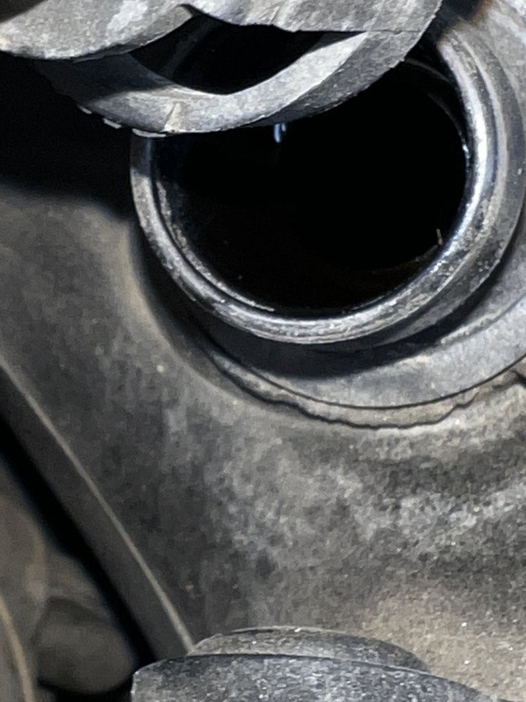

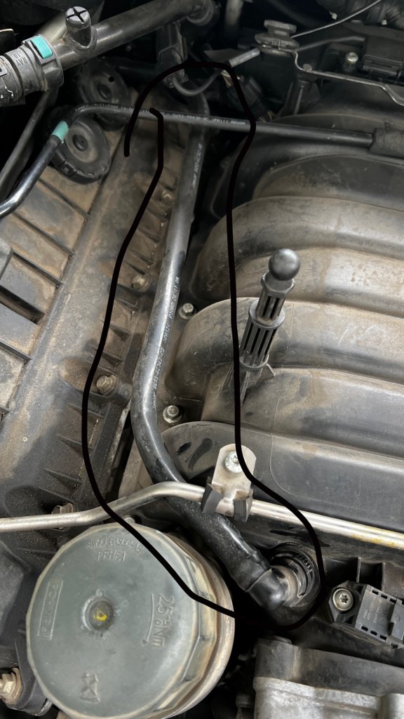

So I checked the purge valve and it was sealed shut. But I also checked a couple of other what I believed to be vacuum lines in the engine. Now on if I’m not wrong (I’m not a genius when it comes to engines I’m just learning the ropes with this truck) there is a vacuum line that comes out of the back of the driver side cylinder head and leads into the intake duct and then another vacuum line that comes out of the back of the passenger side head and leads into the intake manifold. The drivers side line was dry but when I pulled the passenger side line out of the manifold it was saturated in oil. Not sure if you can see how much b it when I stuck my pinky into that hole it came out with oil dripping off of my finger. Is that normal??
Hopefully don’t sound like a noob here but just want to make sure.
In the second photo you can see that there is a ring inside of hole in the intake manifold that kind of disappears, that’s because it’s underneath a little puddle of oil.
I believe you are looking at the crankcase breather hoses. The driver‘s side hose is the “full load” breather, and the passenger side is the “partial load” breather. The partial load breather is connected to the PCV, which acts as a valve to balance the engine vacuum against the crankcase pressure when the throttle body is closed. The system on these cars is notoriously bad and a lot of oil gets sucked up through the partial breather hose and into the intake. But, if your PCV is going bad, you are likely to get a whole lot more oil up through there. If you haven’t replaced the PCV diaphragm in the last 60K miles or so, you might just do it. It‘s a cheap and easy repair - especially on the V8. You just buy the diaphragm kits (you need two) with the rubber diaphragm and spring and new covers, pry the little round covers off the valve cover, replace the parts and put the new covers back. Just two pieces of advice: (1) wait until you have the kits in hand as the tabs on the old covers will break off, and (2) be careful not to break the valve cover itself or the little hooks on the valve cover - you don’t want to turn this simple repair into a whole valve cover replacement.
But - I don’t think the PCV is your problem as a torn PCV diaphragm gives you a pretty major vacuum leak, which would show up as large positive fuel trim.

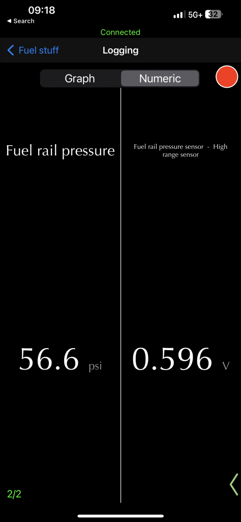

here to bring you guys an update, started checking fuel rail voltage with ignition on before a cold start and I’m getting a reading from the high range sensor at .5 Volts. When the car is started it jumps into the normal range of .8-4v (usually settling at 1.2v when my other sensors normally like sitting around 2.3v.

ok, if I go about replacing the fuel rail pressure sensor how should I go about doing it, should I remove the whole rail and then replace it or should I reach all the way back and try to replace it with out removing the rail? Also what should I use to retorque the sensor, to my understanding it doesn’t look possible with a regular socket.
Also just checking again, below .8 volts with ignition on while the car is cold means the sensor is shot right?

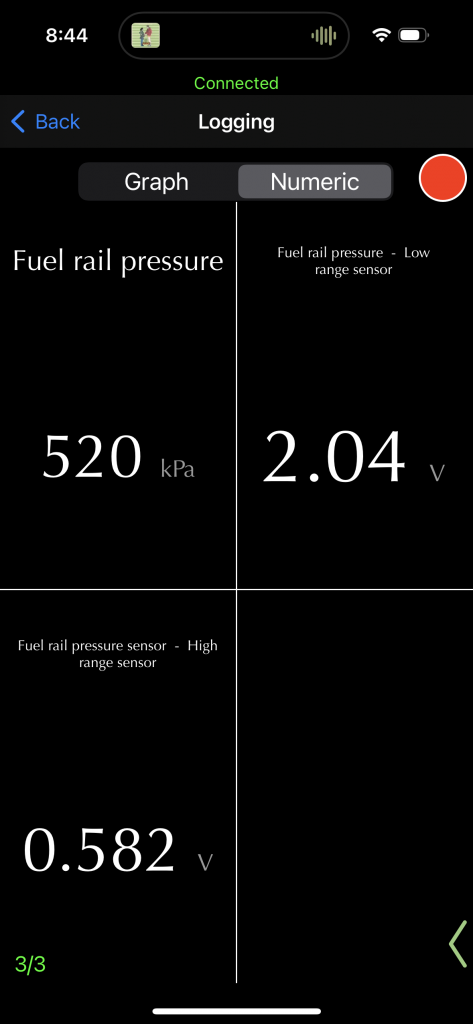

Just went out and checked my high range sensor and low range fuel rail pressure sensor readings. Screen shot attached. About same as yours (0.5 v). Low range sensor is higher (about 2v). Did you check your low range sensor? I’m guessing that the high range sensor is bottomed out when the hpfp is not running, and the low range sensor takes over at those lower pressures. Not certain though.
I came across this website that has some LR diagnostic routines. They seem to say that the high range sensor should be 1.0, but they also seem to say that a faulty sensor (either high or low range sensor) will be showing 4-5v engine off. So, not sure that 0.5-0.8v means that it is bad.
Could still be the sensor though - might be just a faulty reading on the low range. If it’s not difficult or expensive, might just try swapping it out. Looks like it should not be too bad to get to. Maybe someone on here who has done it can chime in.

Low range was about 2.3 V. Starting to look like HPFP, again just odd it runs fine with good fuel trims
