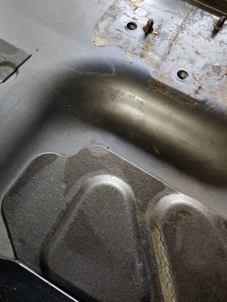

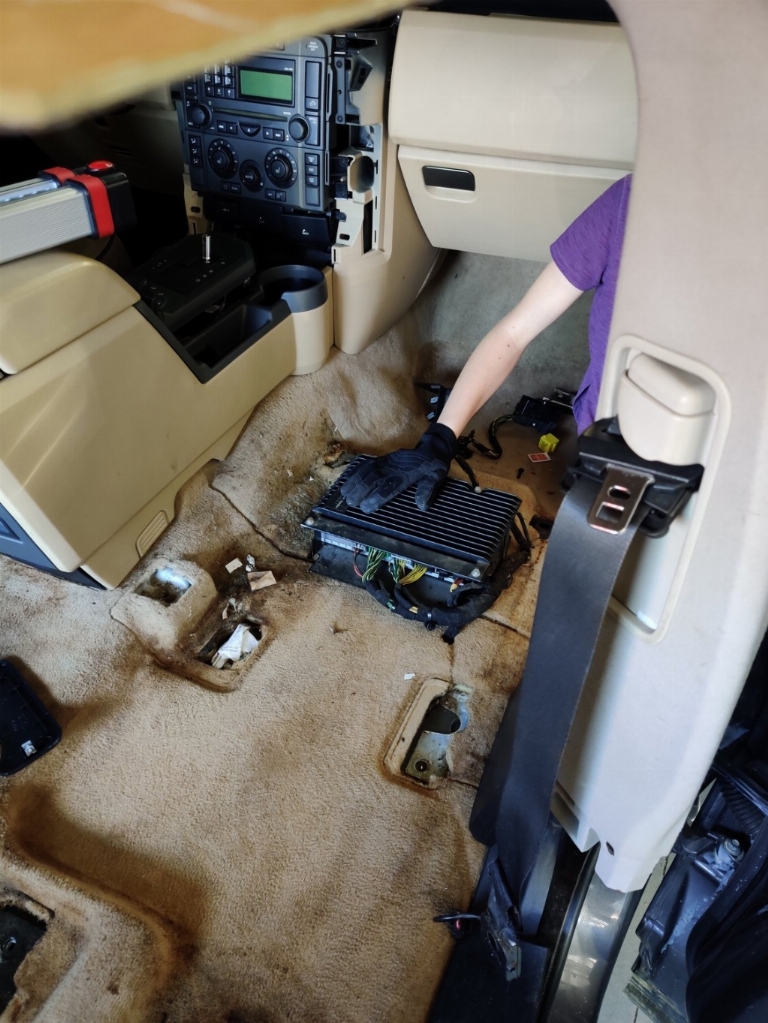

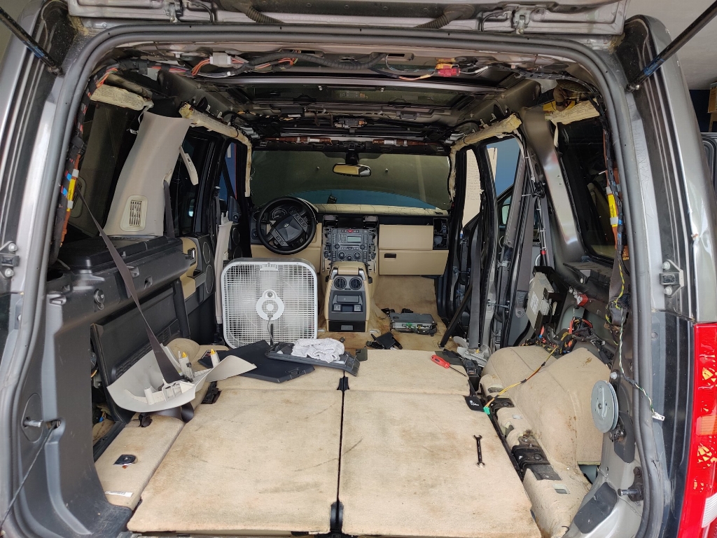

Found more mold obviously. Also found the padding is wet and the trucks carpets were a hot mess. That's the reason we are pulling the console tomorrow so the carpet can come out for a very good cleaning and drying out

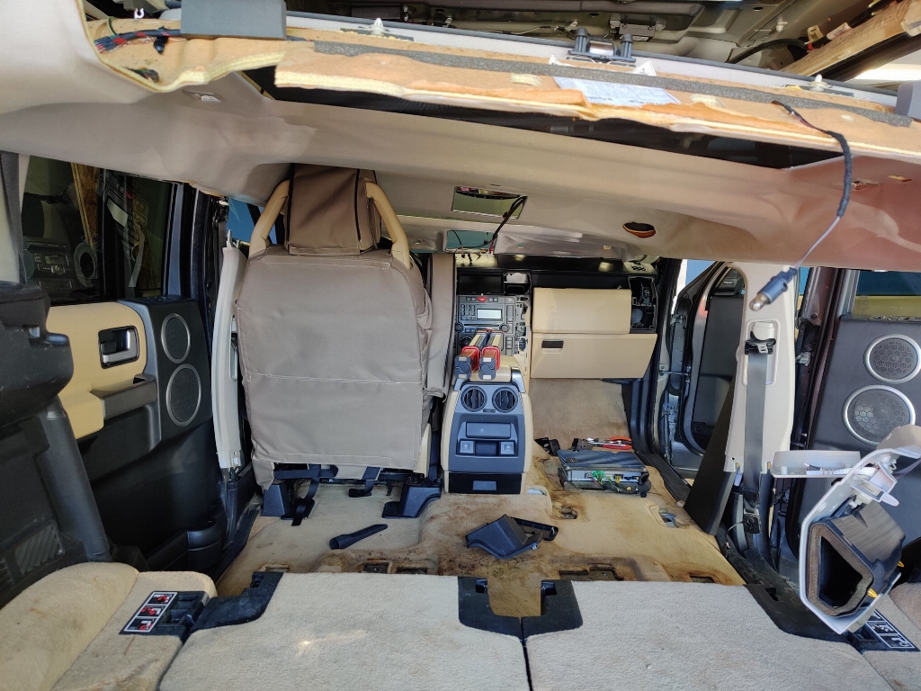

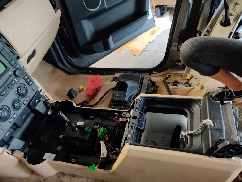

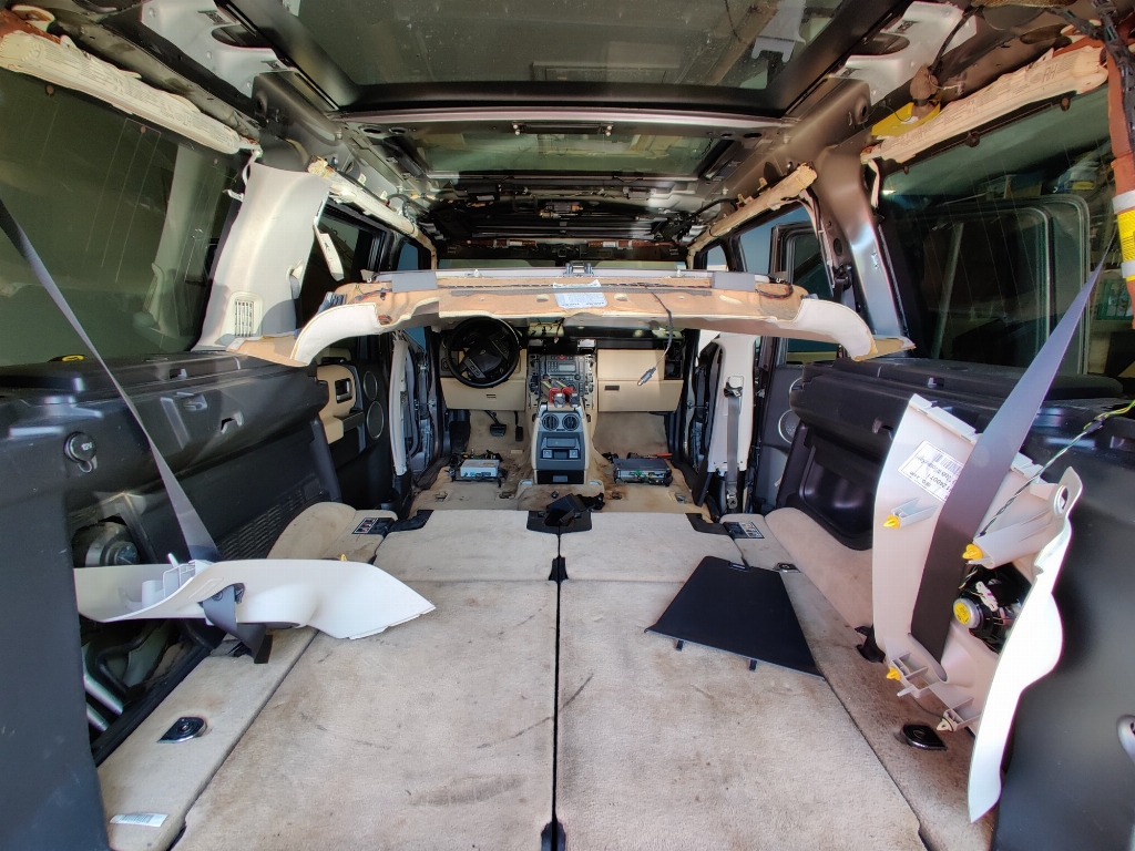

Today's update was we actually got some time to work on it. That stupid headliner is finally out! There was much celebrating
From there we removed a couple more pillar trims and got started on the console. It is absolutely amazing how few tools you need to get this deep into the interior of a LR3.

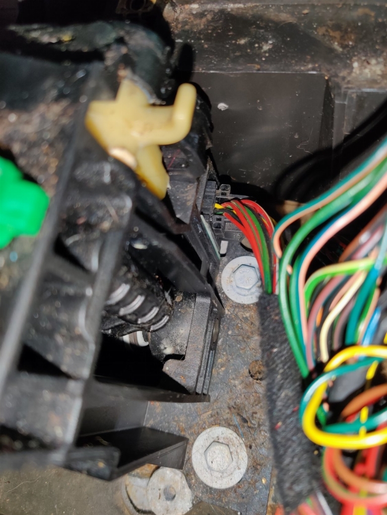

Need to figure out how to pop this connector loose on the shifter and don't want to break anything in there.
ArmyRover
Dec 26, 2012
150
116

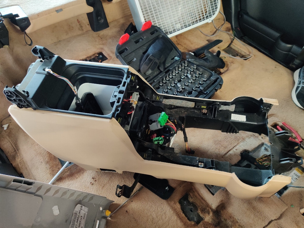

So for those playing along at home it has a little lever lock on that connector that swings down and pushes the connector free. Oonce that was loose the console popped right out. A learning point here is you don't have to really disassemble the console that much to get it out. Lid can stay on. There is two torx bolts on the sides near the back under little vented covers. Two bolts under the front area in the area below the ashtray. Yout have to pop the gray surrounds in the shifter cup holder area and that is pretty much it except for a lot of wiring.

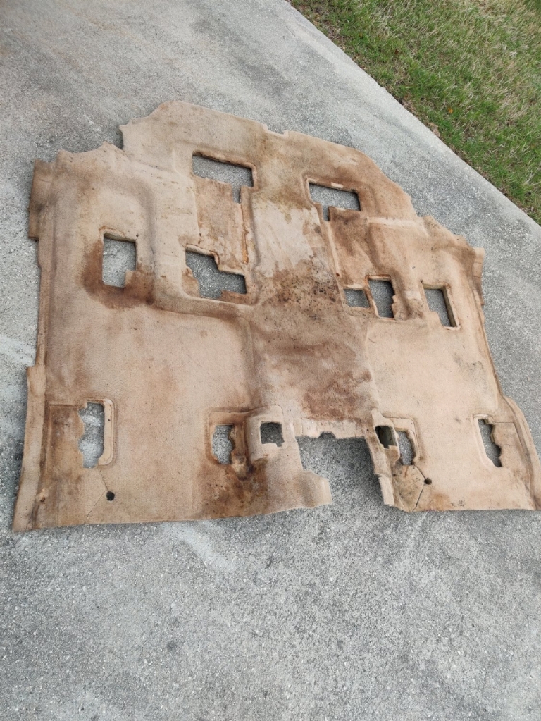

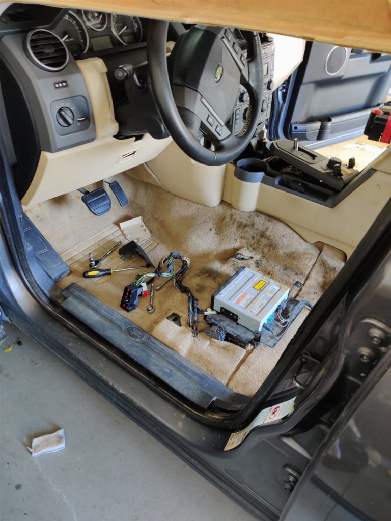

Once that was free the back carpet came right out, in all it's disgusting glory. It was still wet underneath which shocked the heck out of me. Slid a hand under the front half and it was soaked to.
Haven't quite figured out how the lower center dash comes out so we can get the front carpet free. Maybe tomorrow... After I clean that funky carpet to see if it can be saved
