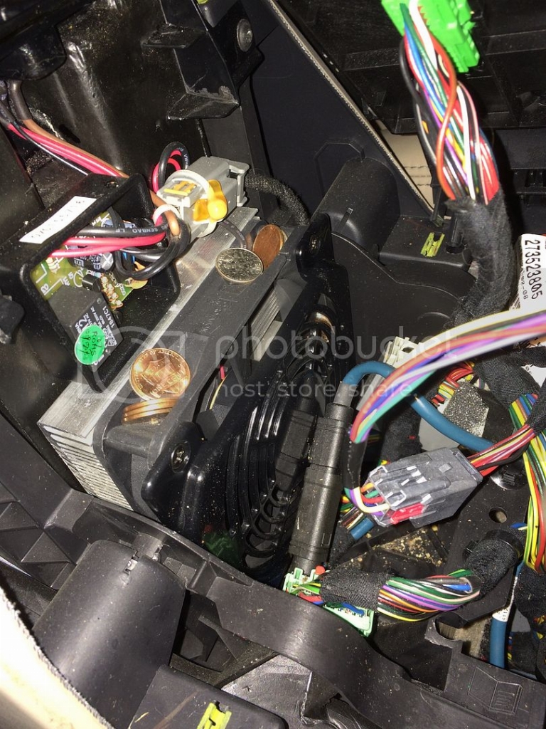

Can't hurt to open up the center console fascia and take a look at the wiring for the cooler box, as well as the fan. When I opened mine up, I found loose change from the PO preventing the fan from running. There's also several connectors under there you can check.
