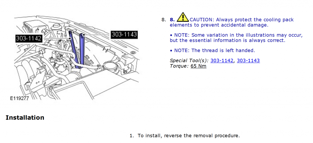

For reference, according to the workshop manual for the 5.0 V8.
