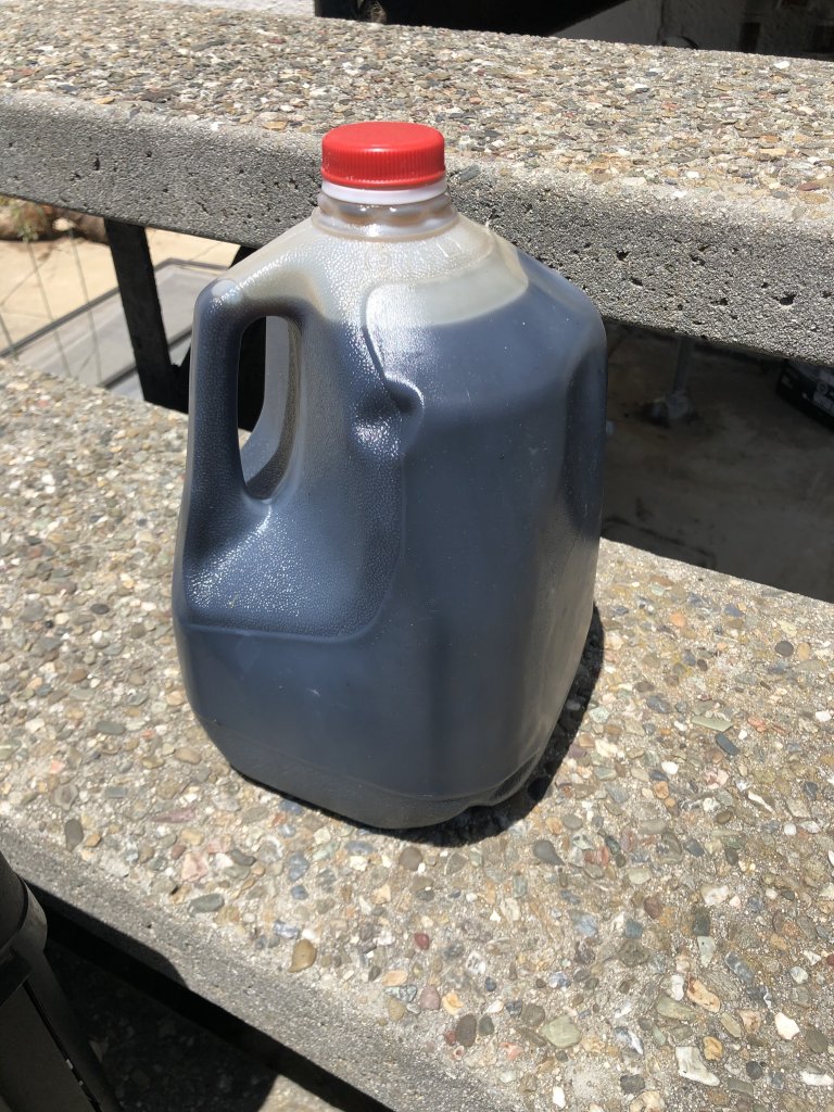

Got under there a few weeks ago to take care of this 9 year, 80k mile old fluid. Thanks to all the great tips in this thread for guiding me through the process. While it took quite a bit longer than expected, a good chunk of it was just figuring out how to take off some of those damn pan screws. I cannot stress enough though how essential it is to have a low profile ratcheting T40 of some sort. I ended up improvising by taping off one box end of a 1/4" wrench and sticking a T40 bit in there to reach those tricky bolts. It was awful.
Had my wife help me pump the fluid (the HF Transfer Pump ($4 with coupon), was very helpful) as I monitored the plug. Ended up only filling about 4.75 QTs. Still have a couple of bottles of ZF Fluid from rover parts if anyone in the SF Bay Area wants them at a discount.
That fluid was definitely due for a change. Shifts were buttery smooth after the change (though they weren't bad at all to begin with)
