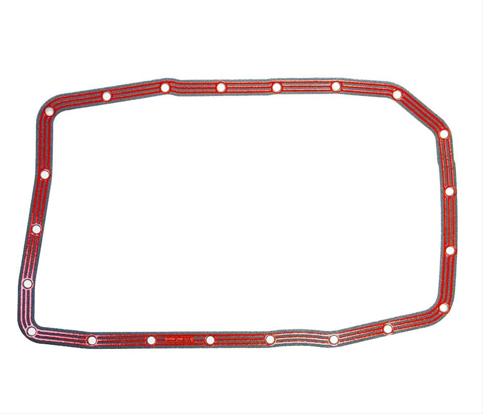

+1 on the pan gasket upgrade to LubeLocker LLT-F6R80.
I bought the metal pan kit from a forum member and still haven't installed it, but I knew on sight that the plain-paper gasket supplied was guaranteed to leak without additional sealant applied (not a good idea on a transmission pan).
I need to order a couple of those LubeLocker gaskets so I can swap the pan and have a spare gasket on hand also. Thanks for the reminder!

it makes me sad only 6 months ago i replaced my pan and used the paper gasket. i wish i knew of this gasket upgrade at the time.
the supplied paper gasket is allowing fluid to seep through. there is no pooling or drips, but there is definitely a residue of fluid around the entire pan at the gasket.

Yes, mine did the same thing even though I had spray sealant on the pan side. I redid it this summer with the same type of gasket before I knew about this other gasket. I put sealant on both sides and it doesn't seem to leak now. I just today got my LubeLocker gasket delivered. Holy how it is nice compared to that paper crap. I am going to redo it again in the spring just for peace of mind. I felt like I was over torquing the bolts with this other stuff.

Well, for once I feel my procrastination has paid off. I've been sitting on my transmission fluid-swap kit for over a year and haven't done the job yet. Now, I've ordered this new gasket, which I will probably sit on as well.

Same here, my procrastination also paid off.
This summer, I finally did a drain & refill (without dropping the pan) and was disappointed to only get ~3.5 quarts out, of a ~10.5 (?) quart total capacity. It's gonna take a lot of messy drains & refills to eventually get 80-90% new fluid in there. I was doing to do a second or third drain & refill, and finally remove & replace the pan on the 4th time.
REALLY annoying that JLR did not put a drain plug on the torque converter. The extra two bucks cost would allow easily draining 100% of the fluid.
