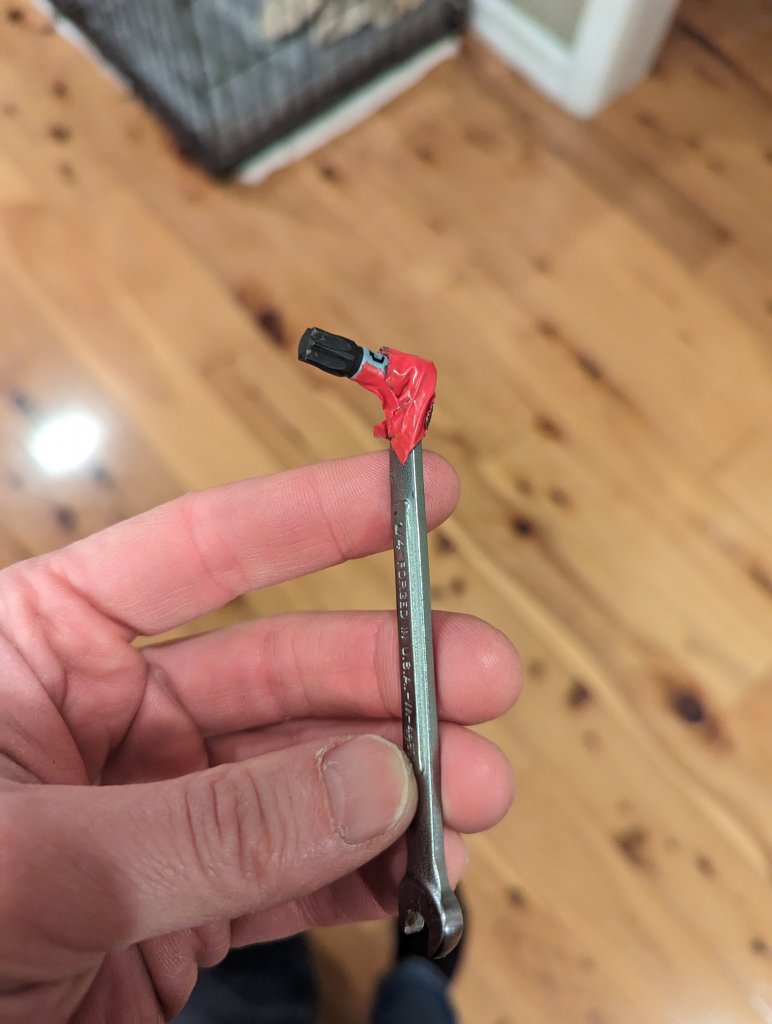

I have embarked on this project and the first issue I ran into was not having a T-40 short enough in the front and back behind the cross members.
My solution is pictured. A Bosch T-40 bit duck taped into at 1/4" closed end wrench. Works like and absolute champ. I just undid the front and back ones in less than 5 mins.
Happy New year, all. Hope to hit this a little bit each day this week. Doing everything but the solenoids. The Sonnex Zip Fix kit arrived and I am very impressed with the directions. Like super Legos.

Made the same tool when I did mine... works perfect. Unfortunately, a torque wrench won't fit on those tough to reach bolts when putting it back together... have to do those by feel. Helps to jack up the transmission, but still couldn't get all of them. This was one of those maintenance jobs where I could feel the improvement in the way the car shifted/drove. Love those repairs.... unlike the damn crossover pipe job. Cheers.

That set is sweet, how could I not spend $12 on that? Will show up after the job is done but handy to have, thanks!

I'll warn you that the torx bits themselves in that kit aren't the best quality, but any standard bit works in the ratcheting wrench itself.
