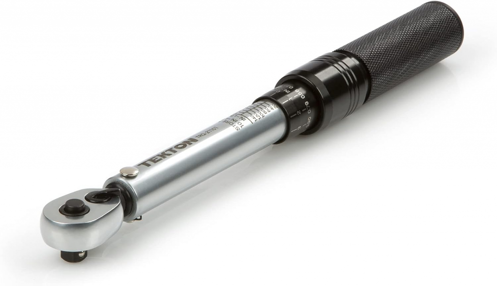

Here's another option for a low-torque 1/4" wrench, the TEKTON mode TRQ21101 is rated 1.1-16.9 Nm:
