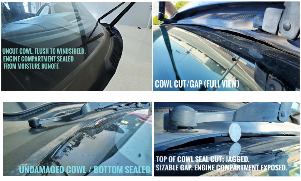

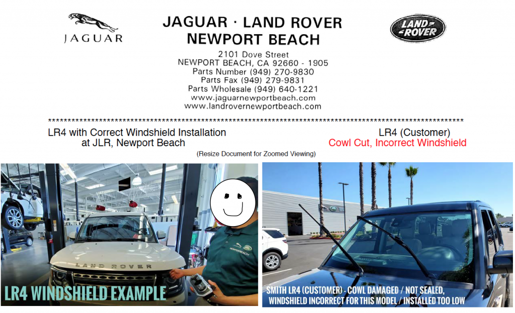

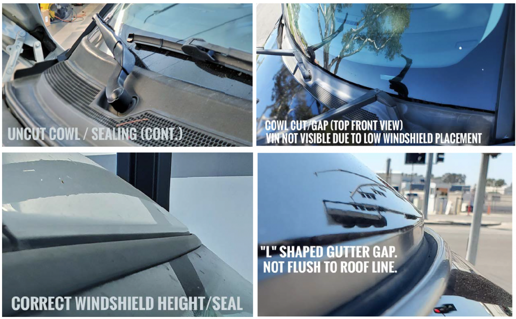

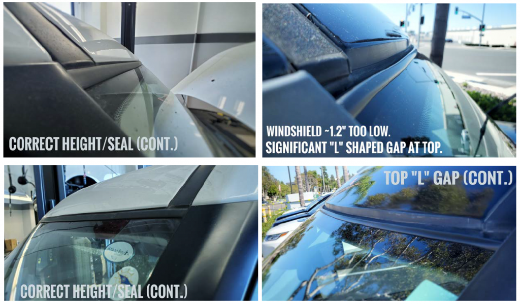

@Tapps33 nailed it in his post above.
We replaced our windshield just after we purchased our LR4 a little while back, and the company (higher end, non-Landy dealership) that sold it to us had originally hired Safelite to replace the windshield/windscreen prior to the LR4 being listed for sale. I don't know what issue the previous windshield had, but the dealer deemed it worth replacing before offering for sale.
During our 7 Day "Try It Out" period, we took it in to Jag/LR, Newport Beach (who are amazing, I'll add... best dealership experiences we've ever had anywhere) here in SoCal for a thorough pre-purchase inspection for any issues, which they do not charge anything for, by the way. Their guy who does all windshield replacements (a 3rd Party specialist they hire in who does phenomenal work; a detail oriented, good man) happened to be there, walking past, and noticed our windshield just looked... "off", so he took a closer look.
Quick backstory interjection... prior, I'd noticed that the windshield cowl had a jagged edge and was not sealed flush to the windshield. I'd planned to buy a new cowl and install it myself, thinking it was simply just old and slightly warped from the heat, as our LR4 has always been Southwest owned in Calif and Arizona. In hindsight, I should have taken the cowl condition as a cue to look closer at the windshield...
Upon further inspection, it turns out that the windshield was nearly 1.2" too low, and the jagged cowl was not warped all, but had actually been straight up cut away with a box cutter-like tool, then the wrong windshield was slapped into place. We have the Climate Package with heated windshield for melting frost/snow on cold mornings in the California mountain highlands where we live. The replacement was a Fuyao "direct replacement" piece of junk from China that had no heating element wires and was the wrong size to boot, hence sitting too low.
Soooo... some Safelite tech decided to cut (aka, damage) the cowl rather than take off 3 bolts to remove it properly, ignored the heating element feature/connectors entirely, then installed the wrong windshield 1.2" too low. I mean... really? lol
So we took these findings to the seller/dealer and said, (paraphrased) "hi there, we'd like this windshield to be installed properly, an uncut replacement cowl so that the engine compartment isn't exposed to the elements, and the proper windshield part so that the Climate Package, that was noted in our purchase paperwork, works as designed."
The seller was very understanding and apologized for the problem, saying they would certainly take care of it for us. I mean, we get it... in a normal situation, if they (dealer) had purchased the vehicle with the windshield already in this condition, then we are out of luck... as-is sale and all. But in this case, they'd hired someone to replace it after they purchased the vehicle, so were reasonably liable to remedy it. They didn't have a problem with that logic either.
After a couple days and some phone/email tag, we got a call from Safelite's main office; they apologized 100%, were very friendly and professional, and wanted to have a chance to take care of it. Can't fault them at all on their customer service or desire to make it right. They seem like good enough people, but the problem though... our trust that Safelite would do the work well was pretty much zero. The reason all of us were in this position was because of their shoddy/hurried work to begin with. lol
Now they want to do an even more involved job to rectify their first go at it? Now the cowl has to be replaced, the proper windshield needs to be installed with no reference point for the next tech of correct height placement, as well as hooked up (which requires removing the front interior pillar panels). Does their tech know we have rain sensors? Has the tech ever hooked up a heated windshield before? Etc, etc...
It's not like we didn't like Safelite or anything, they were super friendly, and frankly, we weren't even mad about the whole thing, but we just wanted it done right. The JLR Newport windshield guy has been doing Landy windshields for over 20 years. Who would you choose? :ciao:
At first, the seller/dealer balked at us wanting the replacement done by JLR Newport because, understandably, the Safelite work was warrantied for repairs and adjustment (i.e. FREE to them. lol) This wasn't going to be a cheap fix. A factory Pilkington heated windshield is about $900, the cowl is about $120, plus the install kit fittings, freight shipping the windshield, taxes, and labor. All in, roughly a $1600 job. In contrast, Safelite initially put in a $250 Fuyao, probably charged $100 bucks to install it, and called it a day. How's that saying go.... "the cheap comes out expensive."
In any case, we insisted on wanting the repair and re-installation to be done by JLR, to which the seller/dealer said roughly, "well, Safelite needs to have a chance to fix it per the warranty, then if it still isn't right, you can take it to the JLR dealership." It was frustrating to hear, but hey, insurance and warranty work goes that way sometimes.
I spoke with our service advisor, Armando, at JLR Newport, and he really went to bat with me to get the repair done right at JLR. We took pictures of a properly installed windshield on a white LR4 they happened to have in the shop at the time, the cowl damage vs a non-damaged cowl, and so forth.
I did a bit of research and spoke with some of the LR techs about all that was involved, and then wrote an email to the seller detailing all of the work that would need to be done to fix Safelite's previous foul up.
In short, I told them we had no trust in Safelite to do the work right and that they were taking a chance that Safelite might do even more damage since now they'd need to get into the interior pillars, under the hood to replace the cowl, hook up wiring, etc.
I think that got the message home to them.
They were running the risk that JLR would have to potentially fix further items and the costs would be even higher in the end.
Got an email response the next day from the seller/warranty company saying to go ahead and take it JLR, not Safelite, and noted in our account that the work would be approved.
I'll add, when at last we took it in for the correct windshield replacement, the JLR windshield guy pointed out to me that Safelite had also gouged the heck out of our roof line just under the rubber seal... a 5 inch long gash down to the metal. Arguably, we could have asked for that to be fixed as well, but that would require paint matching the whole roof and a big headache, I'm sure. I just didn't want it to become a rust problem mainly. Otherwise, it's covered up visually. He assured me that he would fill it in for rust proofing and would cover over with the windshield sealing.
Picked it up later and it looked IMMACULATE. New cowl, amazing seal work, perfect fitment, Land Rover logo'd Pilkington heated windshield, can actually read the VIN# now... ;)
Here are some pics from when we were making the case for repairs at JLR.

View attachment 11475 View attachment 11477 View attachment 11478 View attachment 11479
