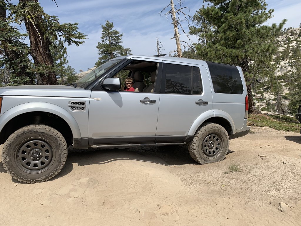

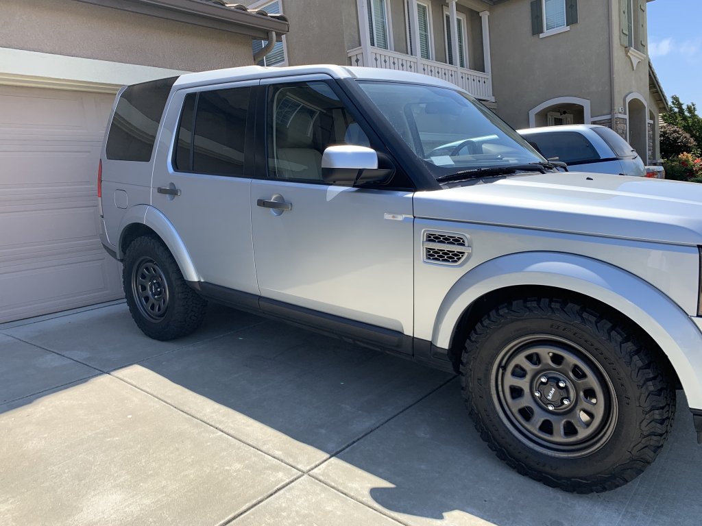

Here's a pic of the TuffAnts (brand new and on the trail) with 265/65/18 ko2s. I did not install tpms but disabled them using the GAP Tool.
