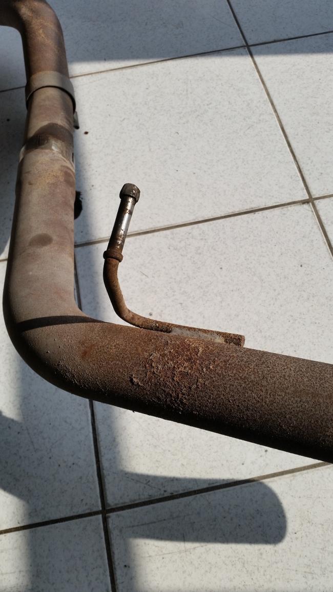

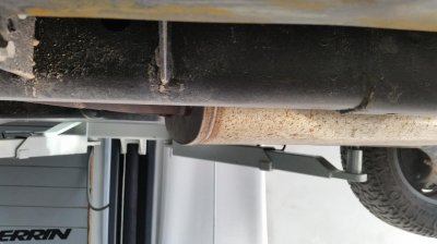

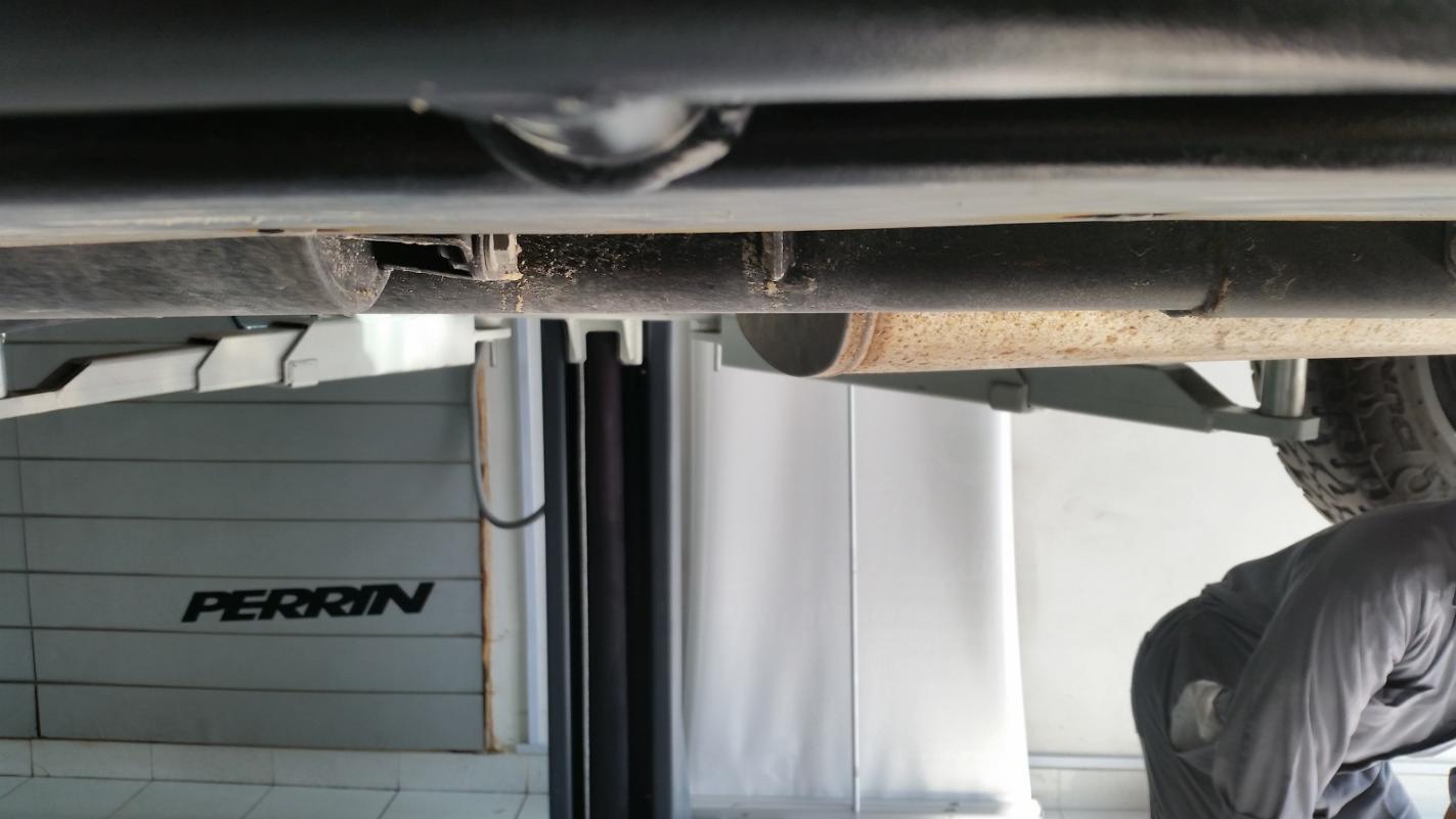

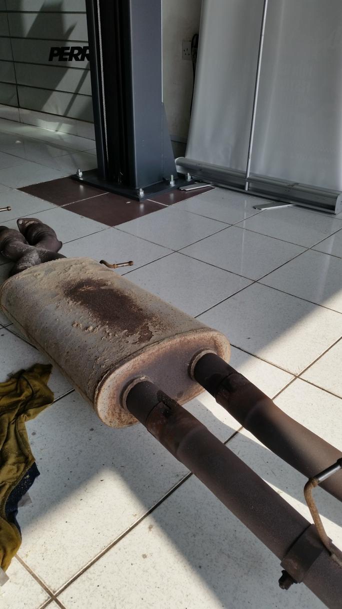

Major flaw: the muffler actually hung too low. It was just poor design. The stock muffler sits nice and high, there is plenty of space for a higher mount of the Magnaflow, but the way the kit is designed, the muffler hung down a solid inch below the frame and anything else on the truck. The part that hung down presented a flat face to catch objects. I actually had the muffler pulled out of the band clamps TWICE by simply hitting sand dunes with the muffler.
Lastly, the entire thing is made of a pretty low grade "stainless steel". It didn't take more than about 6 months to take on the color of rust from front to back. This is a common complaint against all Magnaflow exhausts. Their response is that surface rust is normal, but they guarantee it will not rust through. I wasn't pleased with that answer. For the price of that kit, they could use a better quality SS.

Here are some pics showing what I was talking about.
