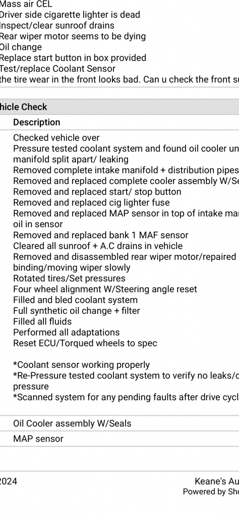

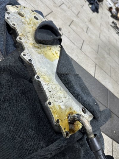

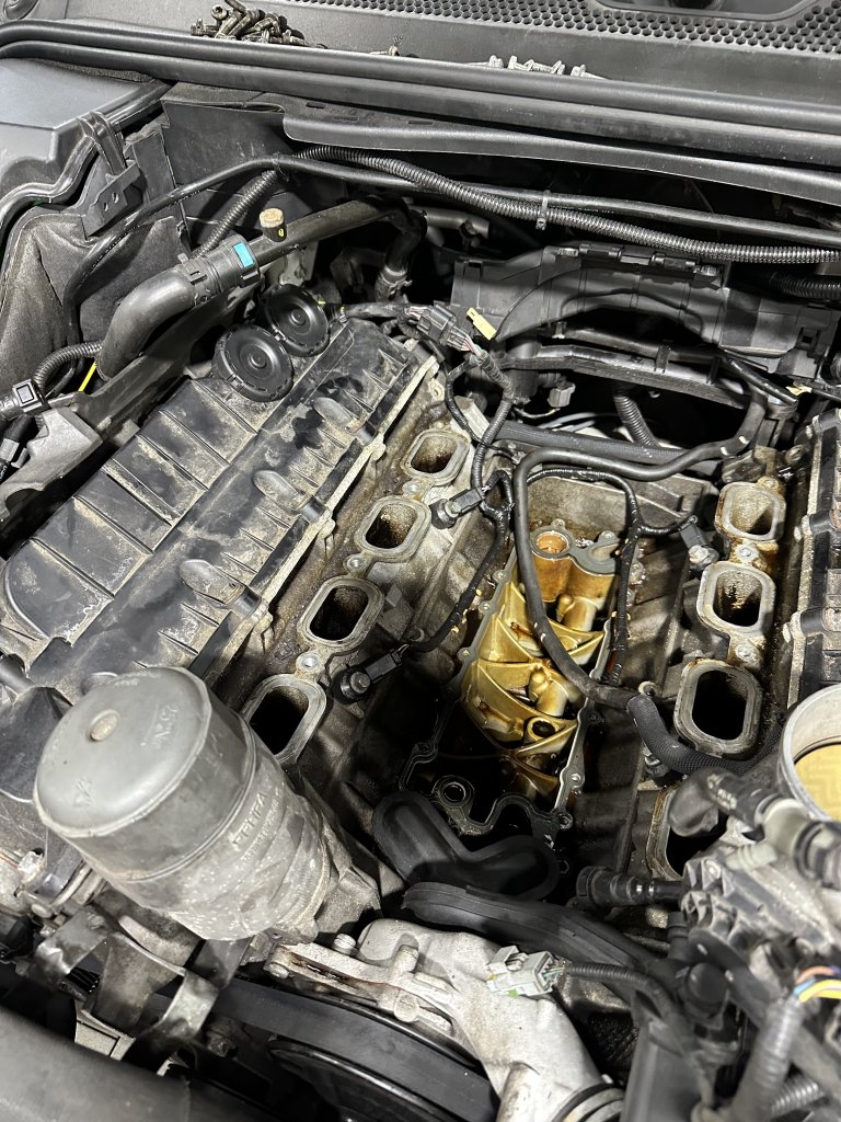

It just wont stop. Now my oil cooler blew up and was losing coolant.
