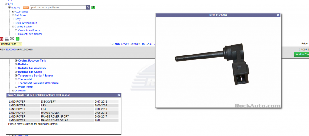

Here is a tip. When your coolant level sensor goes bad (and it will) you can replace just the sensor (about $8) instead of replacing the whole recovery tank.
