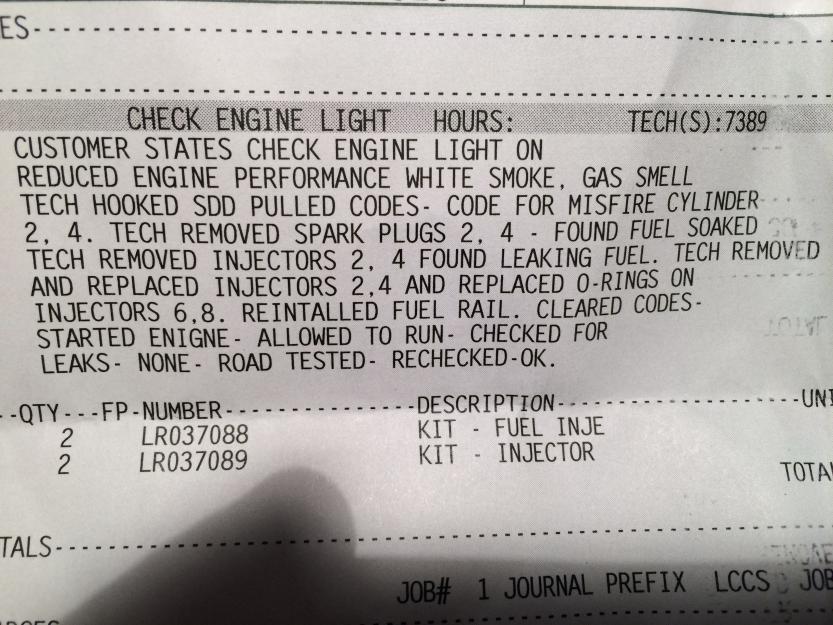

Just picked up the LR4. So far so good. Actually feels like its driving better than before the problem. Engine seems to be smoother and I feel as if I have some more power. Could be my imagination, but I definitely notice a difference.
Here is what was done.
So what is your theory? Bad fuel? Bad install? (the leak?)
I'm not sure. I think it may be just a bad install. Or a bad batch of Fuel. Just not sure what would have caused this and neither is the service manager.
