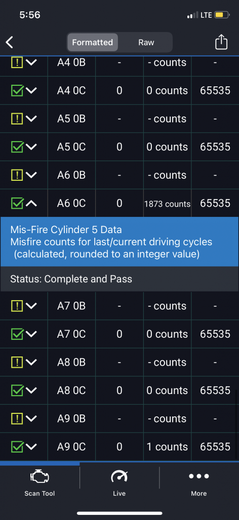

Misfire Cylinder 5 - Advice?

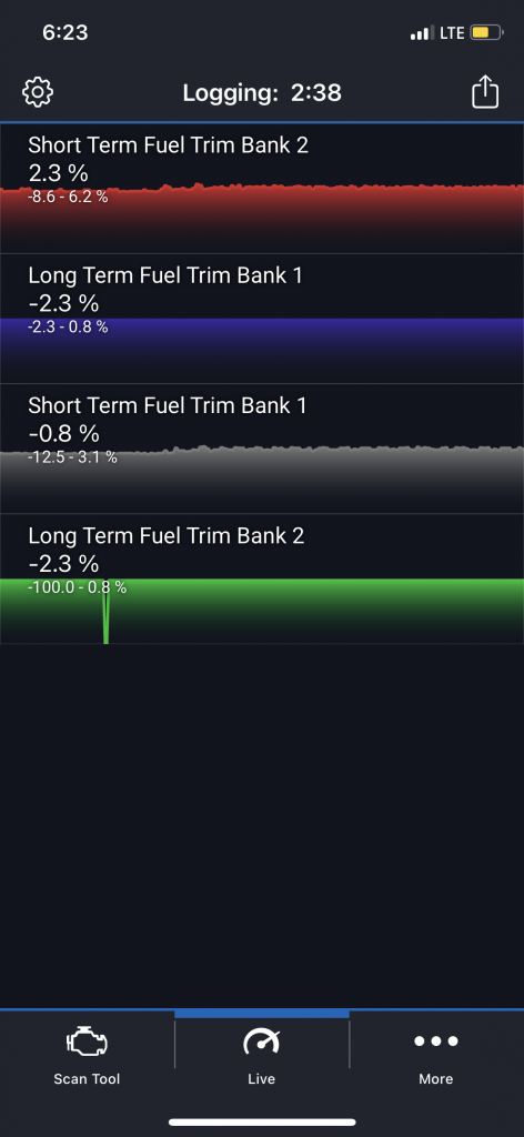

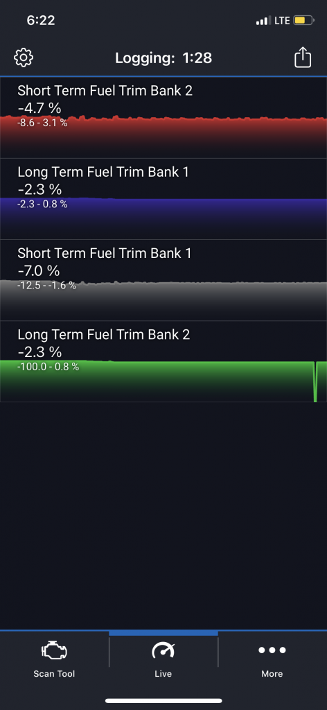

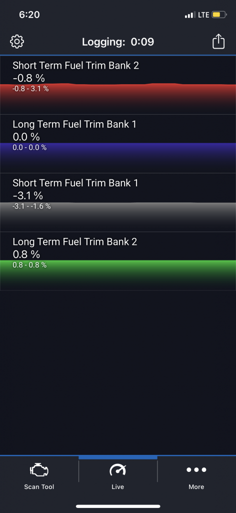

EDIT: Fuel trims at IDLE, 1,500RPM & 2,500RPM (W/ Plenum reattached)

After reading my fuel trims I am realizing that I probably left the vacuum line under the intake plenum undone. Going to reconnect and get new fuel trim data.... Stay posted.
EDIT: Fuel trims w/ plenum reattached posted above
