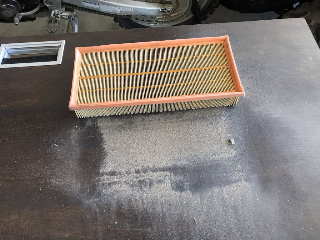

Alright, well this is embarrassing...

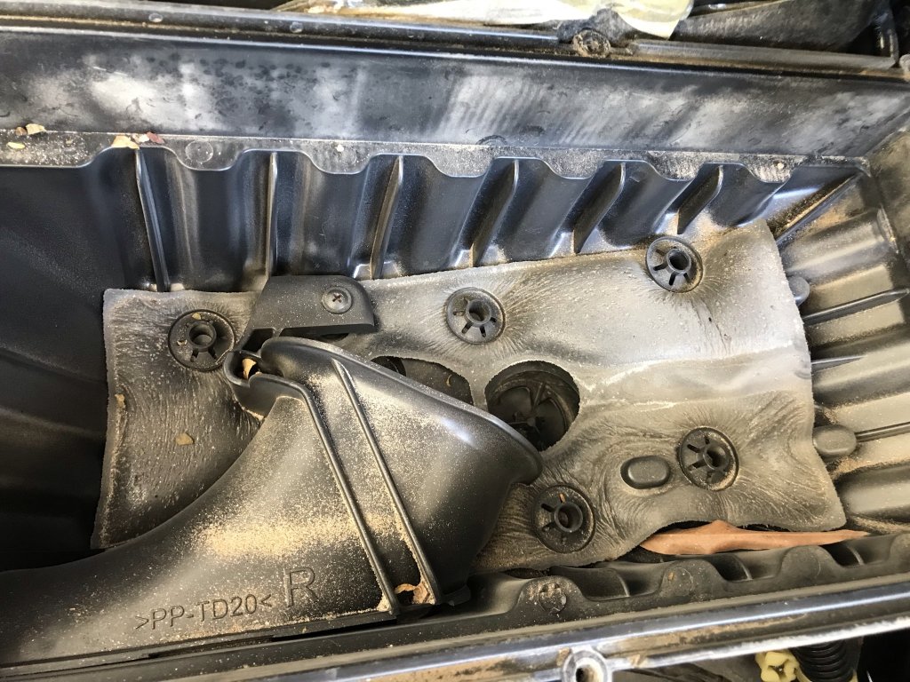

Both filters looked like this. Full of sand. New ones will be here tomorrow. Both air boxes were also full of sand, so I vacuumed and rinsed them out. MAF sensors look clean and dry. I do tend to off road a bit, and it's dry and sandy here...
I had previously checked them about a year or year and a half ago, but definitely screwed the pooch on this one.
Good news is the intake (post filter) is sparkling clean, so they're still doing their job... just a bit past retirement.
This probably has a small impact on performance.

So I ordered new filters and cleaned the old ones until the new ones arrive (tomorrow)
I'm going to do a semi controlled MPG test today, and then run sea foam through my engine (motor treatment via fuel tank) and then maybe do the sea foam top engine cleaner (spray via intake)
I will keep the thread up to date if anything changes. Not going to remove injectors or plugs yet.
1,415
The good news is that an old clogged filter still filters fine, it just doesn't flow lol. I doubt you will see much gain considering the 5.0 has two filters. It would take a lot for the filters to be the restriction. That is a lot of sand though..
