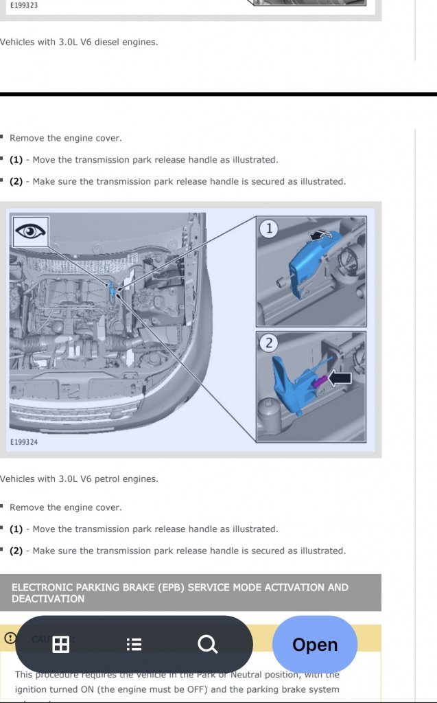

Yeah...so no way to easily access the battery. What about manual neutral override?

I’ll have to look it up. It exists.
I had an Evoque prior to this and once had to override the Park setting. In all the newer Rovers it is either under the hood towards the front of the transmission or under the center console.
MikeP
Mar 26, 2018
17
Pound Ridge, NY
It’s slightly different with the various engines, but this is the 6 cyl petrol engine.

I’ll peek to see if it’s there when I get it back. Been a week without it, so far. Hoping to get it back next week

It is there, although the plastic but tends to slip putting the car bakc ni to gear so you might have to wedge something into place to hold it there. Although, there is no parking break override/release. Not sure why LR did this even though all the other range rovers and prior discovery’s had one. Perhaps if your battery died they just didn’t want your car moving, at all?
