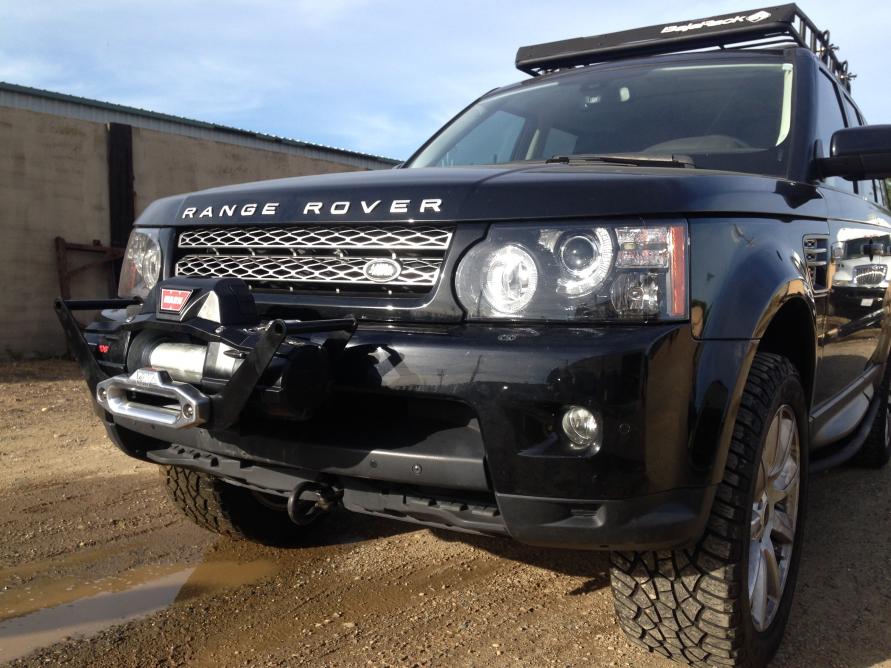

The winch solution sounds interesting not only for flexibility and utility in actual use, but also for mounting only as needed. The obvious question is strength but I'm guessing they thought that through!
I like the potential utility of this approach as well. I can easily see times when I would want a winch on the rear.

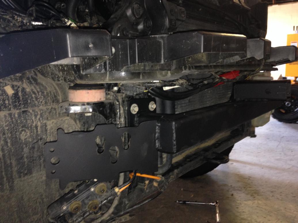

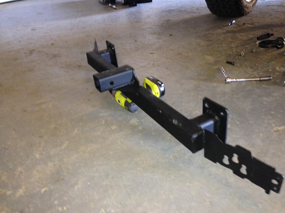

So here are some pics of the multipoint winch thing with a tow hitch receiver that Tim fabricated for an RRS.
