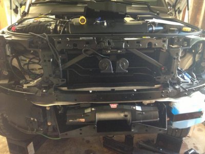

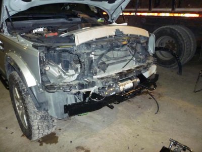

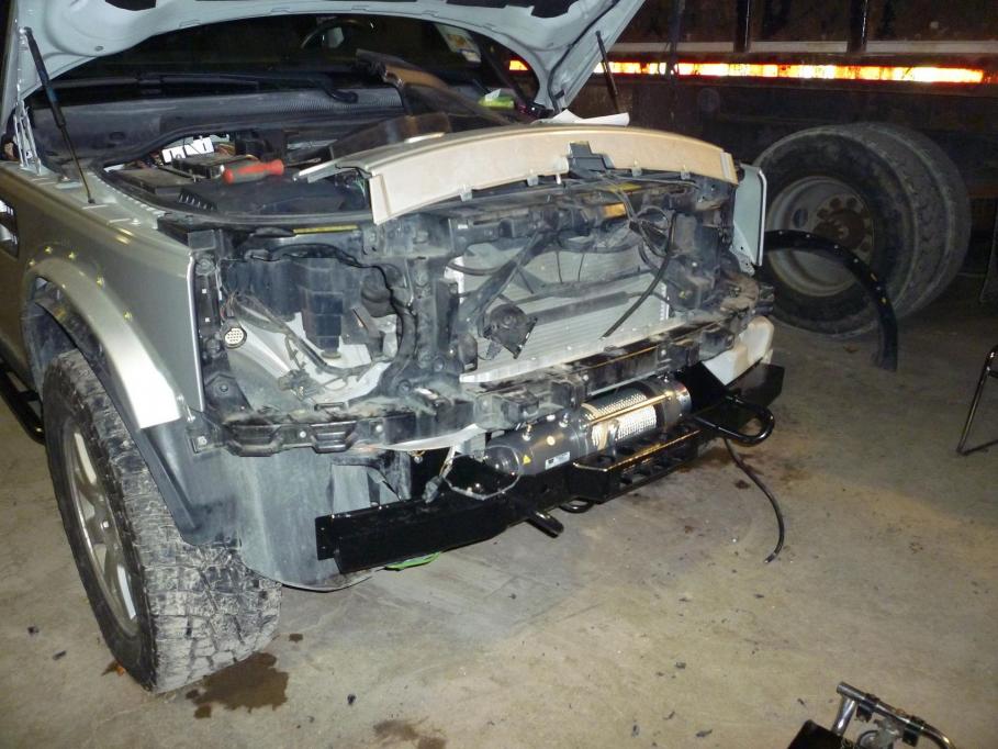

So here are some pics of the multipoint winch thing with a tow hitch receiver that Tim fabricated for an RRS.
Disappointing that like the Terrafirma winch tray, you lose the impact protection in front of the tires.

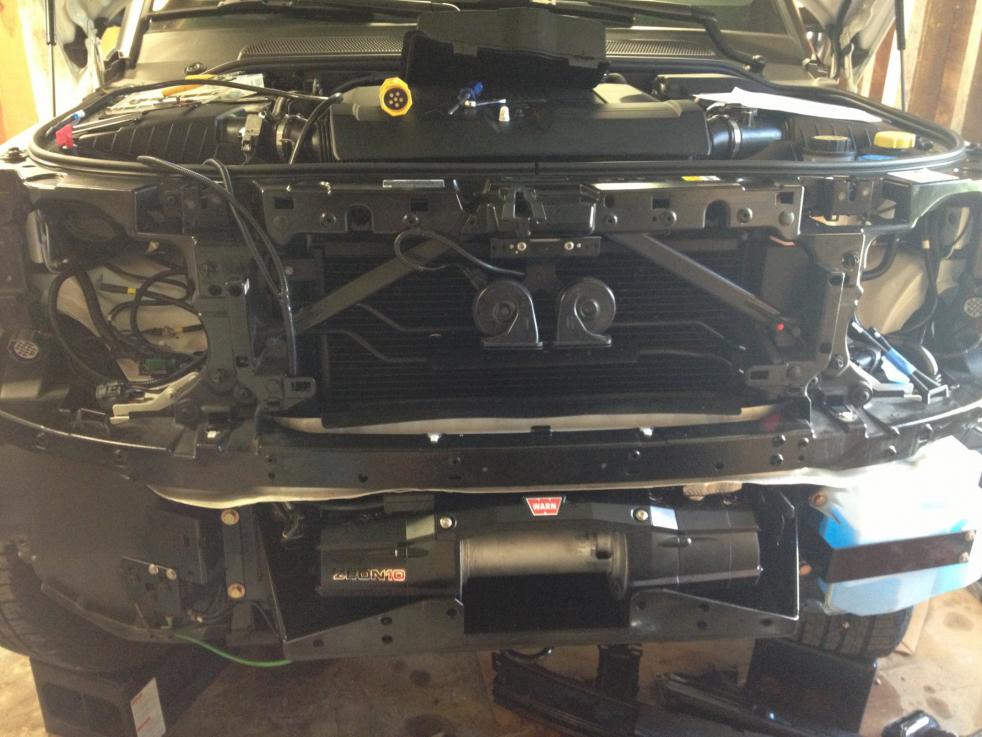

How does that compare with the Devon 4x4 D44 version? I think it looked beefier right?
The D44 winch setup maintains the bumper coverage in front of the front tires (notice the extended box section on either side of the outside frame). This is the same as the stock metal insert of the bumper for crash protection.
Versus the terrafirma which I'm using that does not include the coverage.
