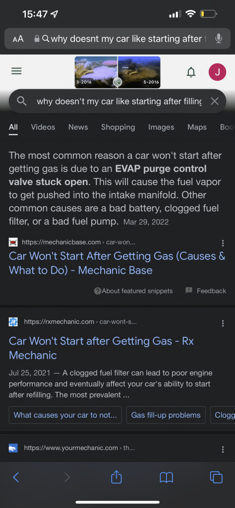

Think I’m going to pull the trigger and do it myself, I’ve had an issue too where when I start my car after filling up with fuel it will barely start but only after filling up. Any other time it will start just fine, it’s done this for 2 fill ups consistently. This was the first thing that came up once I looked it up. I’d say it’s safe to assume that’s the issue.

Purge valves do go bad eventually, so even if that turns out not to be your problem, it is not a complete waste to refresh that part.
Please do let us know if it works. I was corresponding with someone on another forum about a similar issue - strange behavior after fill-ups - and suspected the purge valve or the charcoal canister, or possibly a fuel filler neck issue.
