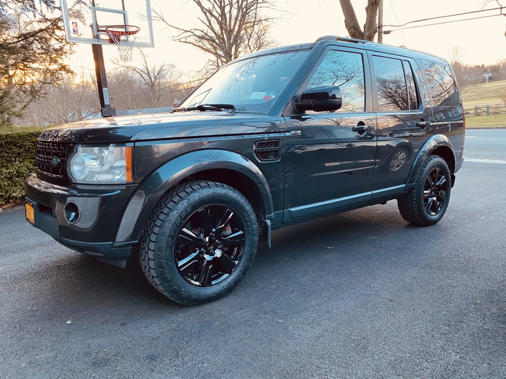

I installed a set of Open Country A/T III 255/60 19 last week and the ride is worlds better than my Open Country H/T and Cooper Zeons.
Wheels where refinished/straightened and the tires were road force balanced on a Hunter.
Your wheels are not balanced correctly.
Looks great! Those are the tires I plan to switch to in a couple of weeks. Any issues going to 255/60?

I can also say that I had Open Country A/T III's installed and they were smoother riding than the worn out Nokians they replaced. I have been very happy with the ride and performance thus far.
I upgraded to this size (19 inch wheels) and had no issues. Very very small rub spot in the rear passenger wheel well, but this is only when you're pushing the car.
