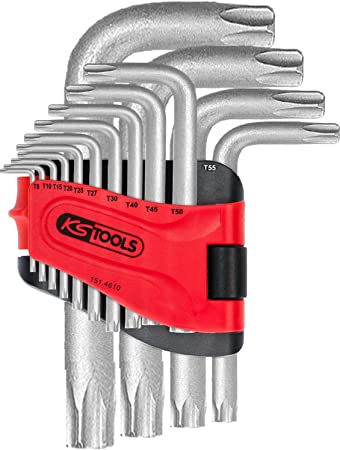

I found it much easier to use a set of these
You’ll curse that the lower bolts have to come out a couple of degrees at a time. But it was easier than using extension bars and u joints for me.
