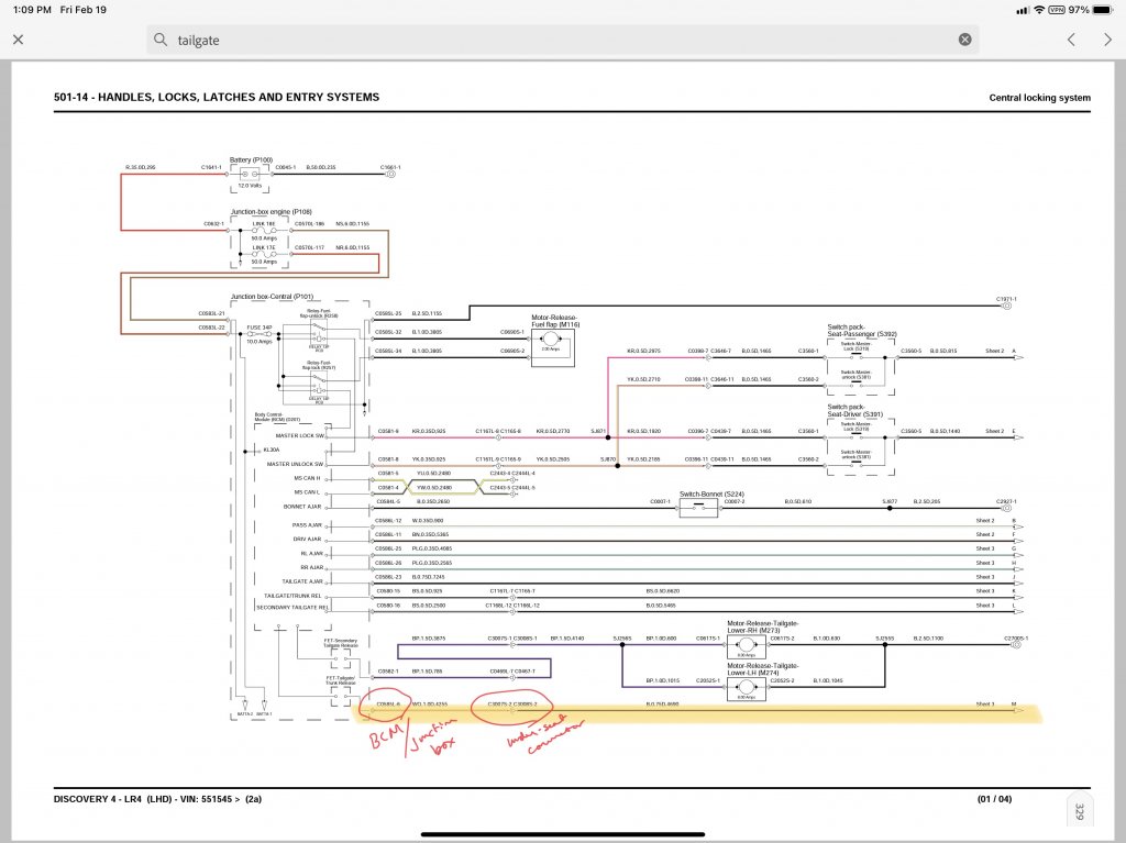

So, you replaced the actual switch (in the upper tailgate handle, correct? And you’ve replaced the actuator, which is working with the lower tailgate switch. If it were me, I’d do the following:

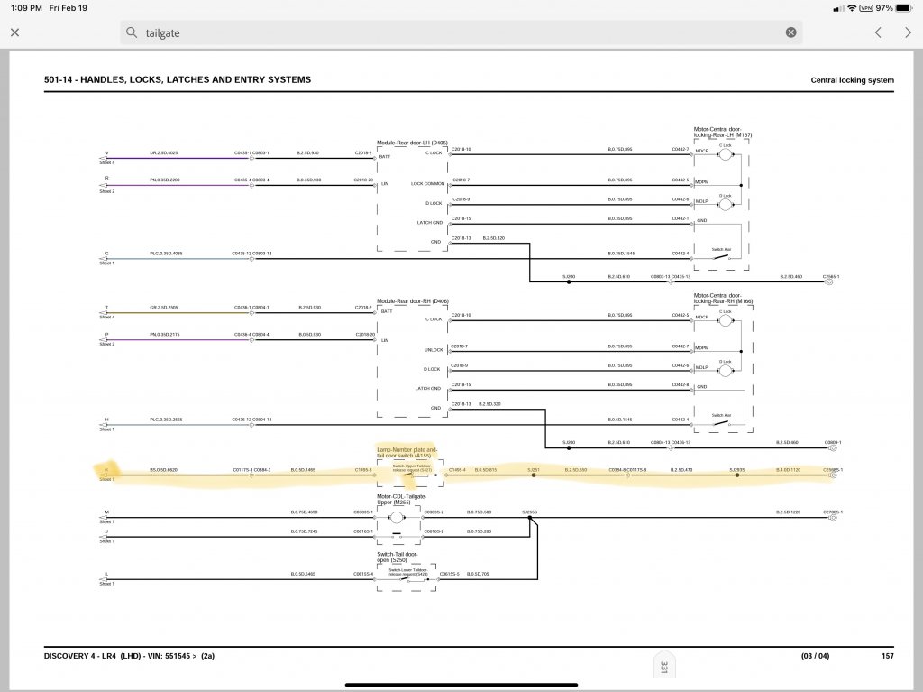

(2) Confirm that license plate lamp is working, and maybe rear wiper (i.e., you’ve got some power going back there).

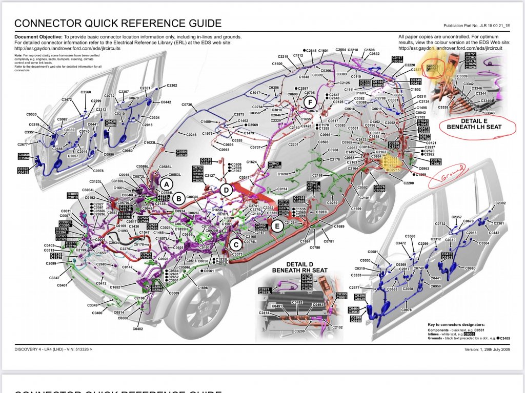

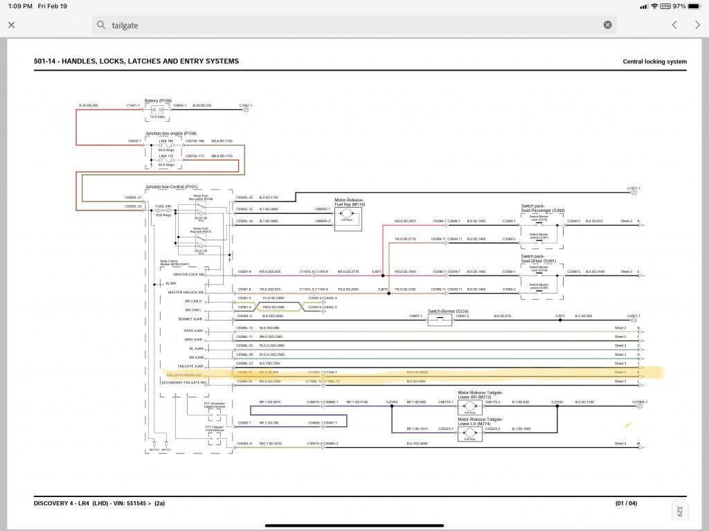

I pulled what I think are the correct wiring diagram sheets for this switch, although I’m not very good with these diagrams. This is probably from a 2011 model - can’t remember what model you have.

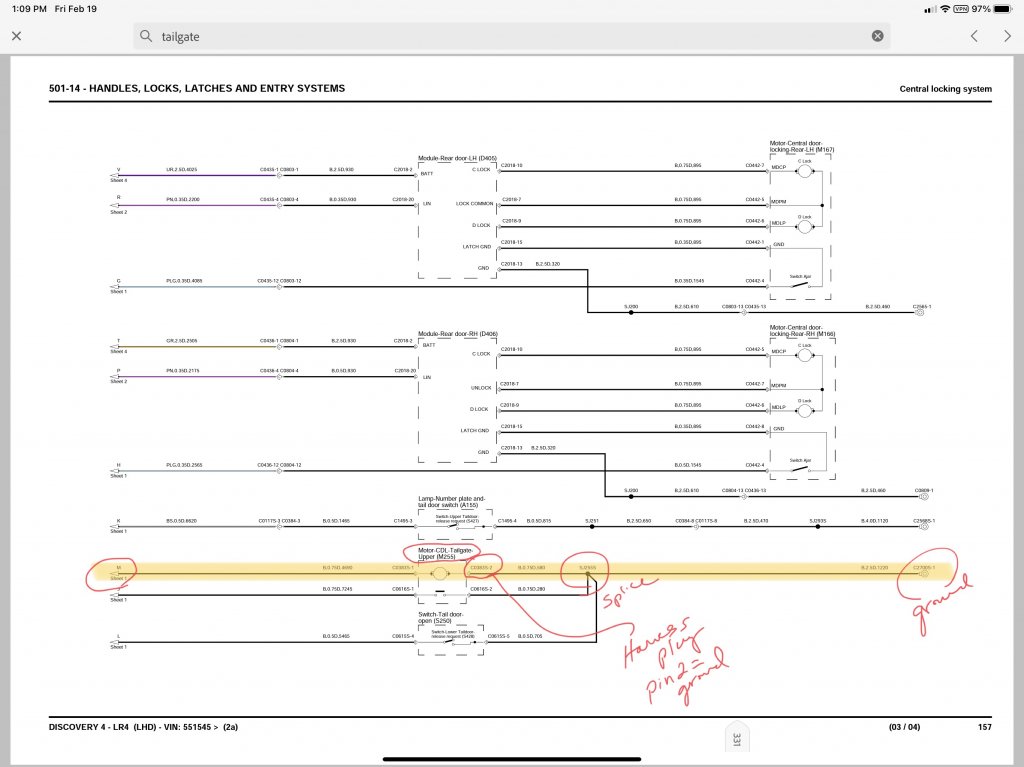

Right, I keep getting that messed up in my responses. That bottom switch button (in the lower tailgate) only controls the lower tailgate actuator. The upper tailgate switch (in the upper tailgate) controls the upper tailgate actuator (which resides in the lower tailgate).
Looking back at that circuit diagram, the actuators appear to be wired for power separately, but seem to share a common ground point. The switches send a voltage back to the BCM, which then relays a voltage back to the respective actuators in the lower tailgate. So, the failure could be in the wiring to the switch or the wiring to the actuator.
But, the fact that the keyfob doesn’t work suggests that maybe the fault is in the wiring to the actuator rather than the wiring to the switch, correct? I think the keyfob communicates directly to the BCM (or at least through a different route), bypassing any fault that would be in the switch side of the circuit.

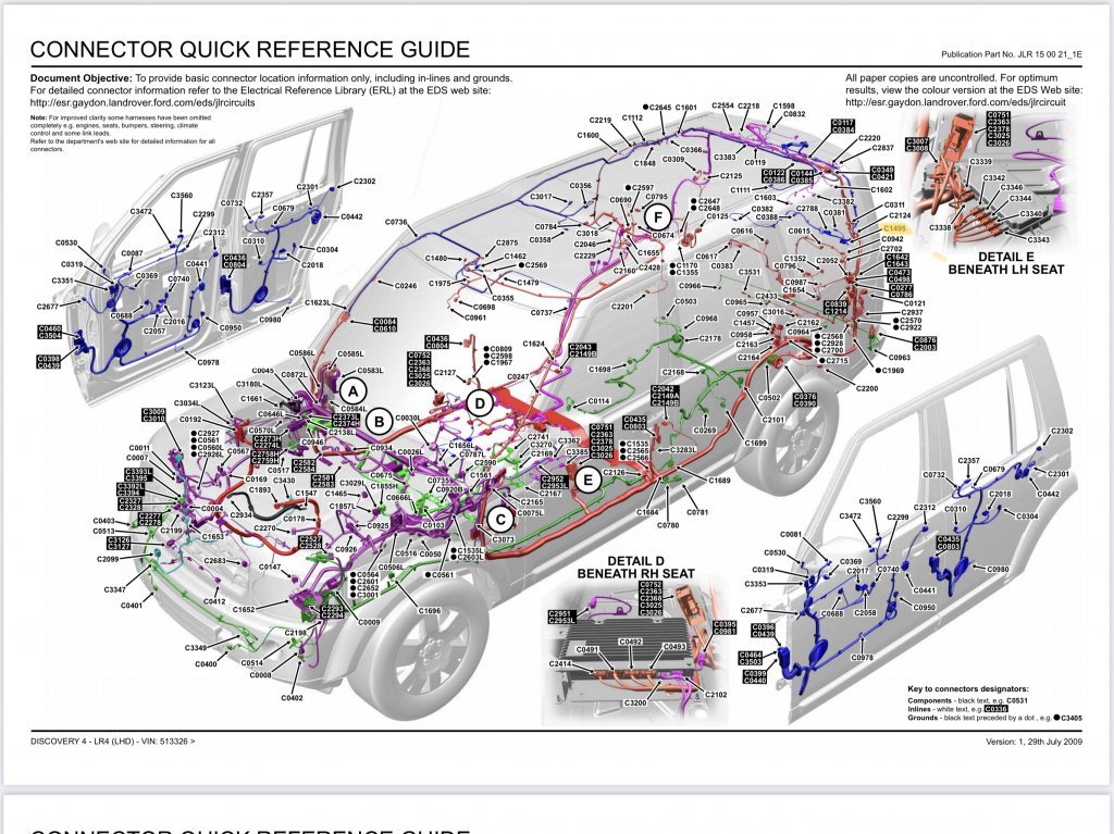

Looking back at the circuit diagram, if the upper switch has power and is tripping the tailgate ajar circuit, looks like there is only two possibilities for the actuator not firing, both along line “M” in the circuit diagram: (1) There appears to be a splice junction (SJ255S - at least I’m guessing that’s what it is) on the ground side of the actuator - the actuator motor, door ajar circuit, and lower door switch all seem to join at that splice joint and then share a common ground after that point. Since the door ajar circuit and lower tailgate switch are working, the ground after the splice must be in tact. So maybe just that one leg from the actuator to the splice joint has come loose. The ground connection appears to be someplace in that tailgate area, so the splice must be back there too. (2) The wiring from the BCM to the actuator motor. Nothing else appears to be on that leg, and there is only a single connector between the actuator and the BCM. This connector is C3007/C3008 below the drivers seat. It’s shown “Detail E” of the connector quick reference that I posted earlier.
Can you check for a 12V pulse at the actuator harness when you press the upper tailgate switch using a known good ground? If you are getting voltage, then the problem must be ground side. If no voltage, then the problem should be on the wiring from the BCM. Or maybe test for continuity between the ground pin on the harness and a known good ground (or the actual ground connection for the harness C2700S-1 if you can access).
If no voltage to the harness, then the same type of test at that underseat connection.
