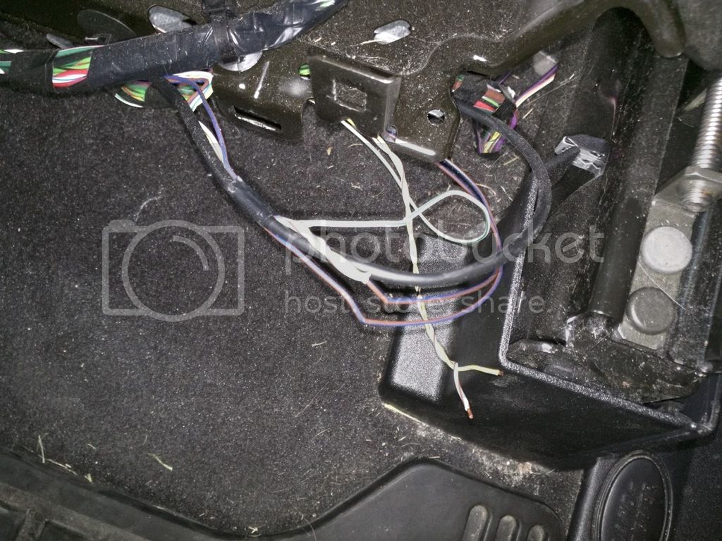

Well, I didnt go anywhere near the wires under the front of my seat during the dual battery install, wasn't near them for the cb remote unit which is under that spot... its near the back... however I pulled the front kick cover off (first ever pulling that off myself).
I find some cut wires. What the flying expletive....
I guess ill fix them, but why the hell do they just have tiny ass telephone gauge wire under the seat right along the rails? Crap electrical tape looking stuff on some bundles but not done very well... jeeeeeeez!

fixed it... just soldered the wires, a little shrink wrap tubing....

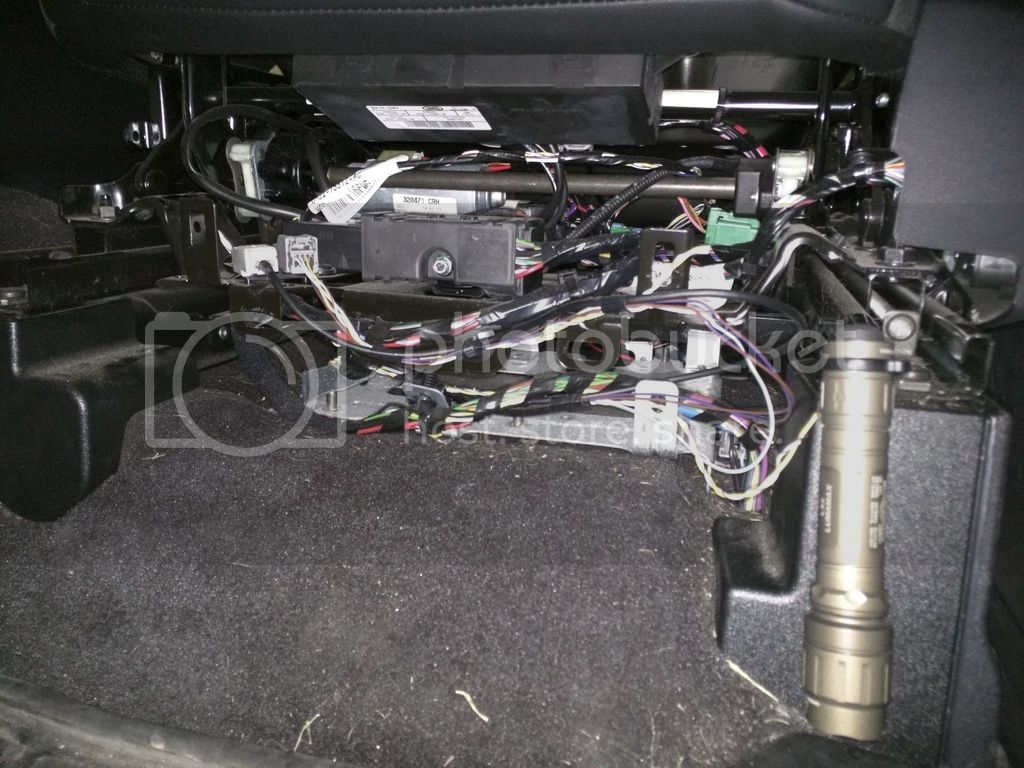

Looks like someone planted a bomb and GPS tracking device under your seat. Possibly also a mainframe computer, a google cloud storage center, a flux capacitor, and a squirrel's winter retreat.
