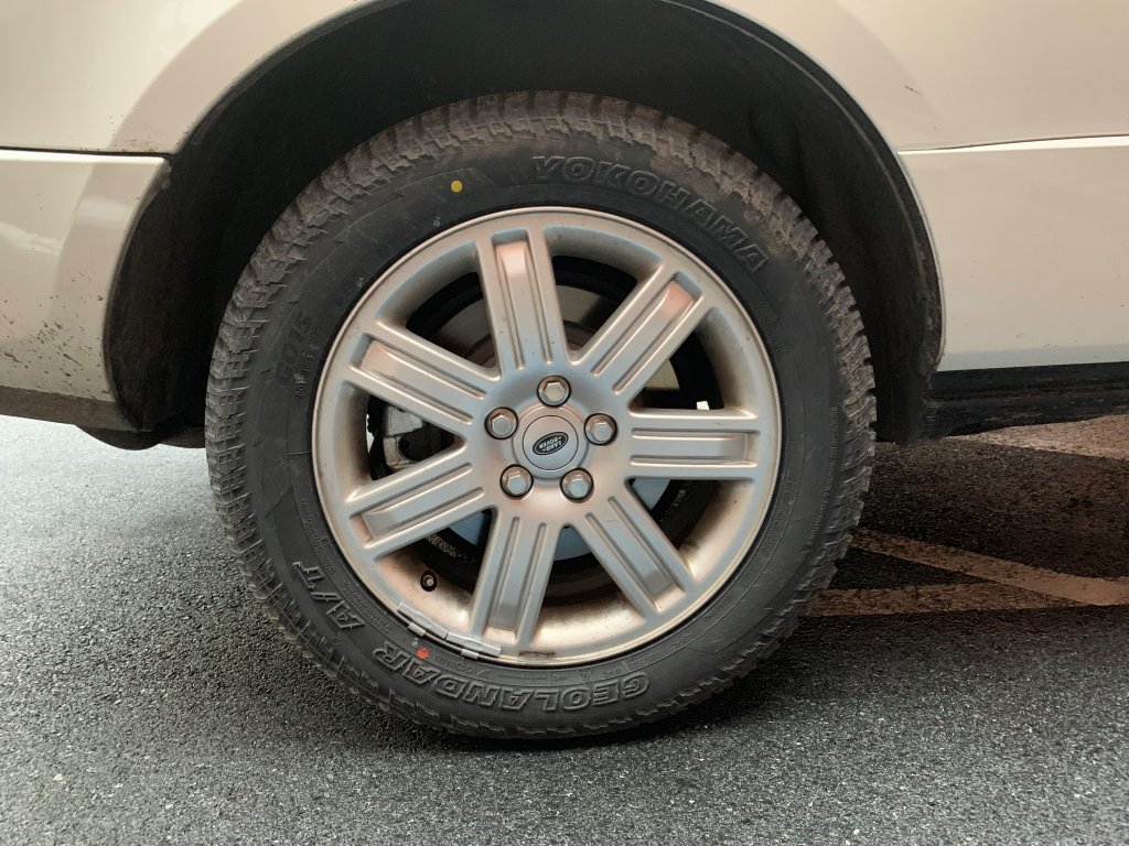

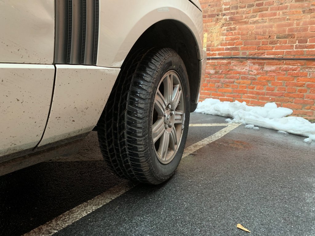

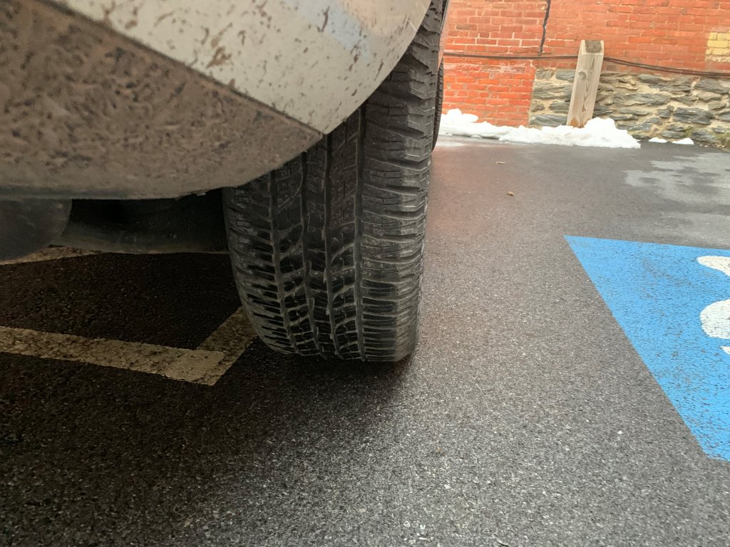

My wife put on the Geolandar G015 on her RR and she claims they are the best tires she has ever had, and she is fussy. She does wish they looked a bit beefier (she had the Duratracs before these), but she could not be happier with their performance in dry/wet/snow (and they are quiet so far, but most new tires are). There seems to be 2 slight variations of the Geolandar tread/sidewall lugs based on images and a set I saw at a local store. The 255/55/19 size actually seems like the "milder" of the two :(.
She does not go offroad, but she does drive well into triple digits mph and they apparently thrive there...
I never took a clean photo of them, but here are some dirty ones from this winter:
This is the other version:
