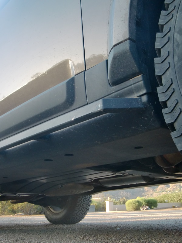

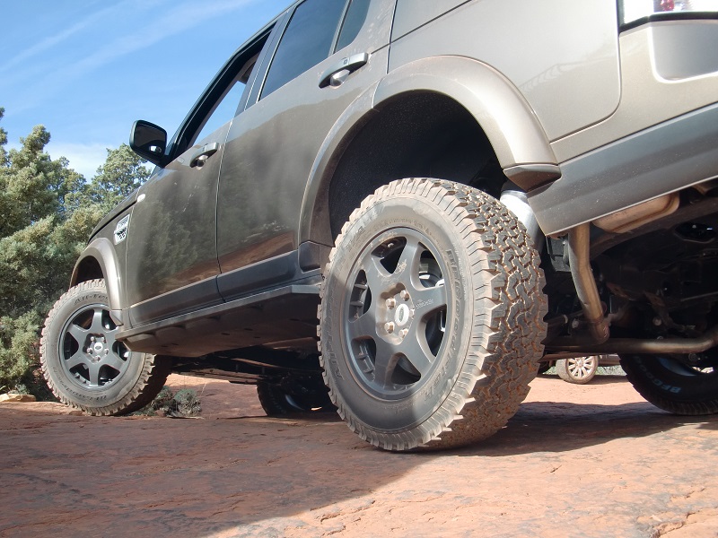

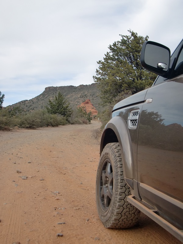

I agree with mbw. I would say If you plan any rock climbing, investment in rock sliders pays back very quickly.:proud: One mistake and your repair is much more that cost of solid rock sliders that cover the compressor and air tank.
In addition they may be used as side steps too.:wink::wink:

They are made by Tactical Rovers.
Rock solid., heavy duty stuff. My rock sliders have nerf bars but you can get them without nerf bars too.

I agree, the Tactical Rovers rock sliders are the toughest you can get - definitely provide the most protection. I have the Urban Offroad, which are good, but do not provide much protection for the air compressor unit. The Tactical Rover sliders are great because they cover all those components (including the air tank). The only drawback I think is the weight and you need to lift up the EAS.
