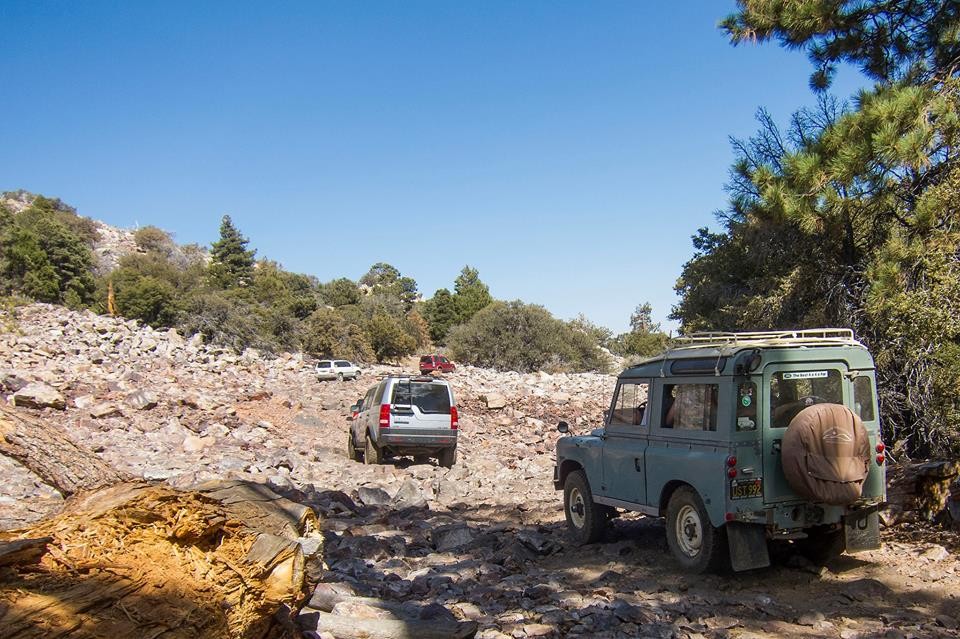

While off-roading over a rock garden in Big Bear a few days ago, a sharp rock must have jumped up behind my front driver's side wheel, and despite all my underbody armor I managed to bend and break the sway bar link, which is surprisingly vulnerable. Pretty sure it happened somewhere here:
Nothing disastrous happens when you bust one of these sticks, but the sway bar is no longer attached on one side when driving as a result (handling is compromised as the car sways too much in turns) and there is this sickening, loud crunching sound coming from the wheel well over road bumps and during sharp compression / extension of the suspensions.
