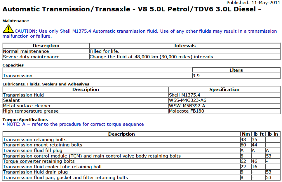

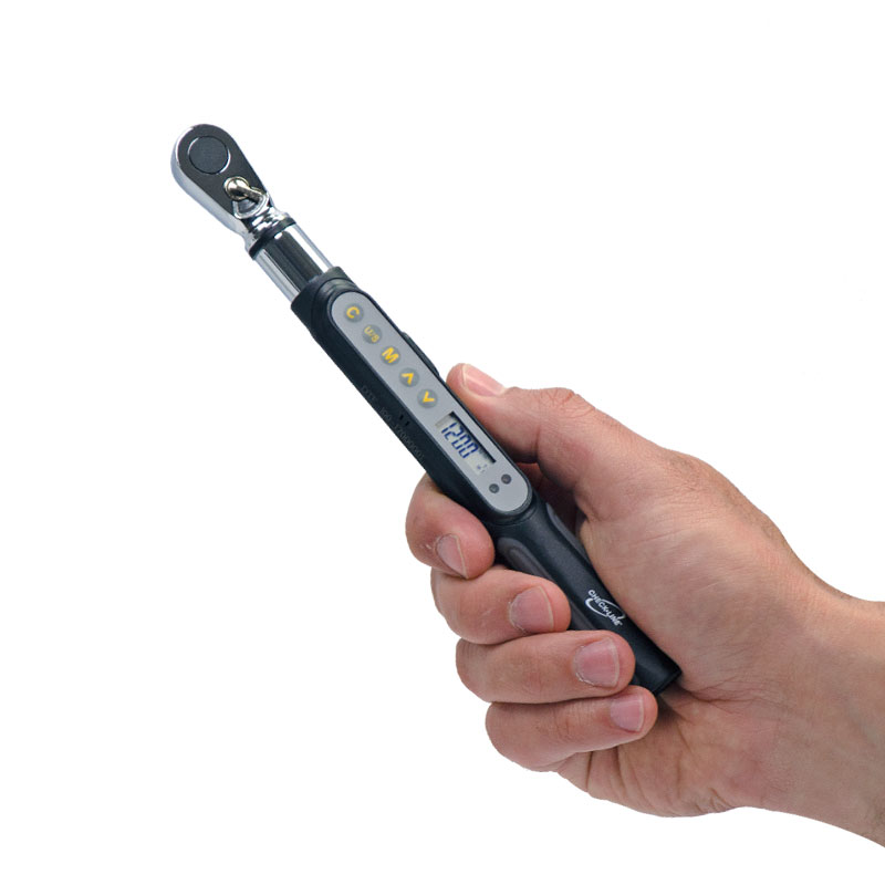

That's such a specialized tool to have a hex head. The first thing I can think of is check in the biking world, I used to ride mountain bikes, and this popped into mind. https://www.topeak.com/us/en/product/316-D-TORQ-WRENCH
You'll also need one that'll do at least 8 Nm according to the V8 5.0L workshop manual.

Park Tools makes great stuff. I have this small torque wrench which covers your 8 Nm but it has a standard 3/8" ratchet head, not a 1/4" female hex head.

That topeak one looks so suspiciously like the one that died on me....
I found a Prestcycle torque wrench, and I know Prestacycle is a good quality vendor, but you have to be able to see the display - no click function...
I used a Prestacycle TorqKey on the crossover project on the 2016, only thing small enough to get in there for the passenger side bolts on the rear crossover.
