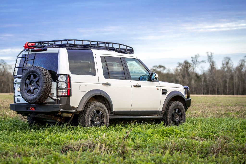

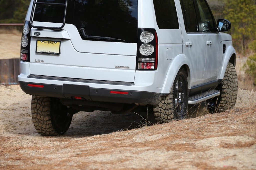

Frank, if you want to consider getting an extra set of wheels, I would recommending getting 18" so you have more tire selection. For the LR4 I like the 265-65-18
You can see them here http://johnsonrods.com/johnson_rods_3_006.htm
Here are a few pics of 18" wheels
