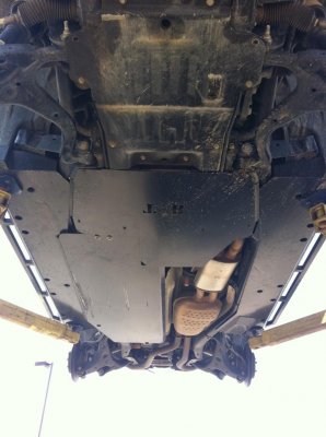

I think I am done with mods for my LR4.
My first upgrade was T44 rock sliders, then I put compomotive wheels with BFG TA/KO 265/65R18. Several weeks ago I installed Asfir sump guard.
Finally today I had T44 fuel tank and transfer case skid plates installed. ( too heavy for me to do the install myself).
It is a great underbody protection "kit". One thing I was unaware was that fuel tank skid plate goes over existing OE plate. It does hang lower and ground clearance is affected slightly but no worry about punctures now.
The picture is not of my truck but shows how T44 skid plates look like installed.
