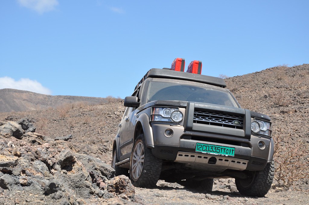

The ManTech Steering Guard looks nice, but I've only seen pics of it fitted with an aftermarket bumper. It doesn't look like it would fit stock.
FYI - if it helps: my ManTech (OEM) Steering Guard is pretty sharp looking and just fits over the OEM Bumper.
Here is a really old, but pretty good (back when the truck was all shiny and still new!) photo which shows the plate quite well over the original plastic (with the OEM bumper and all).

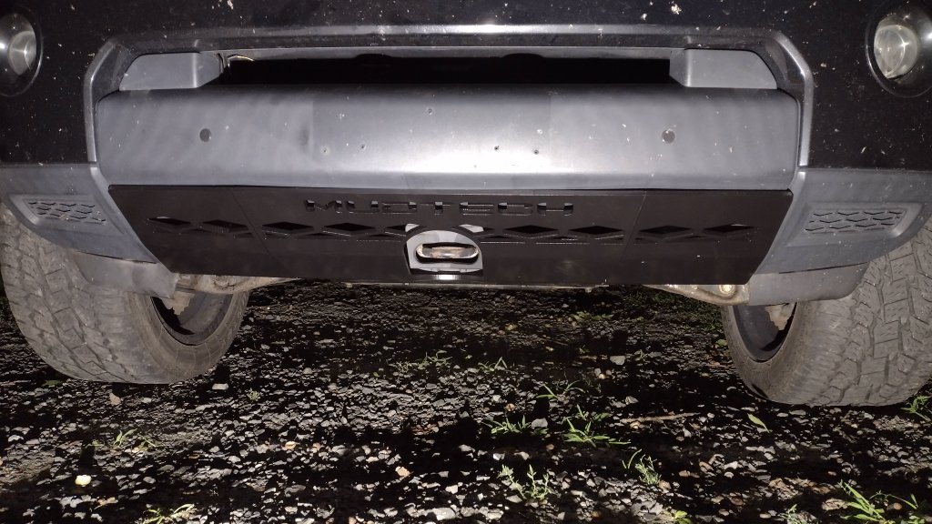

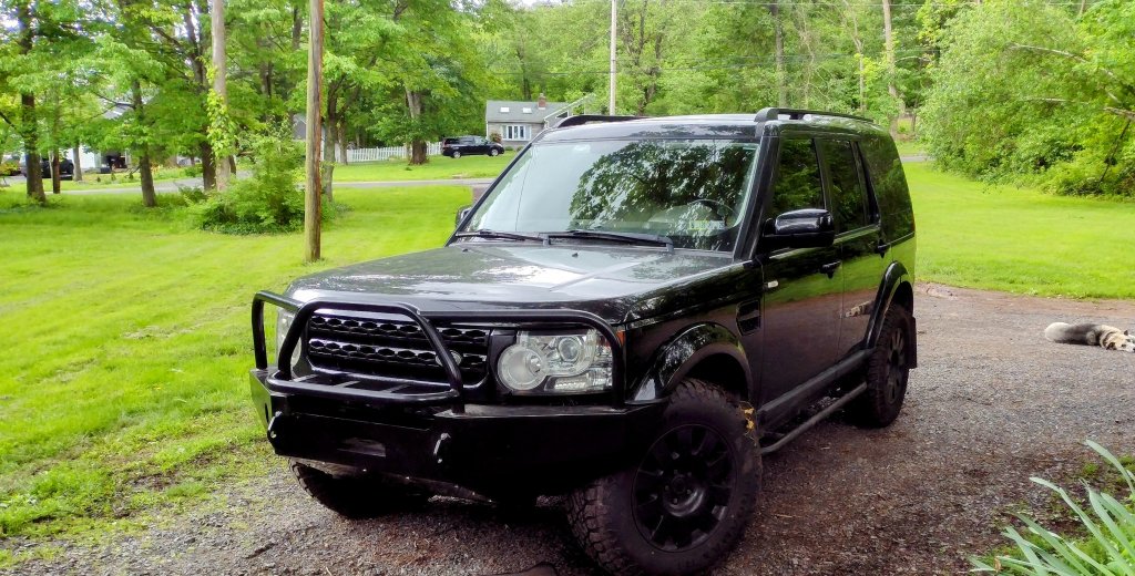

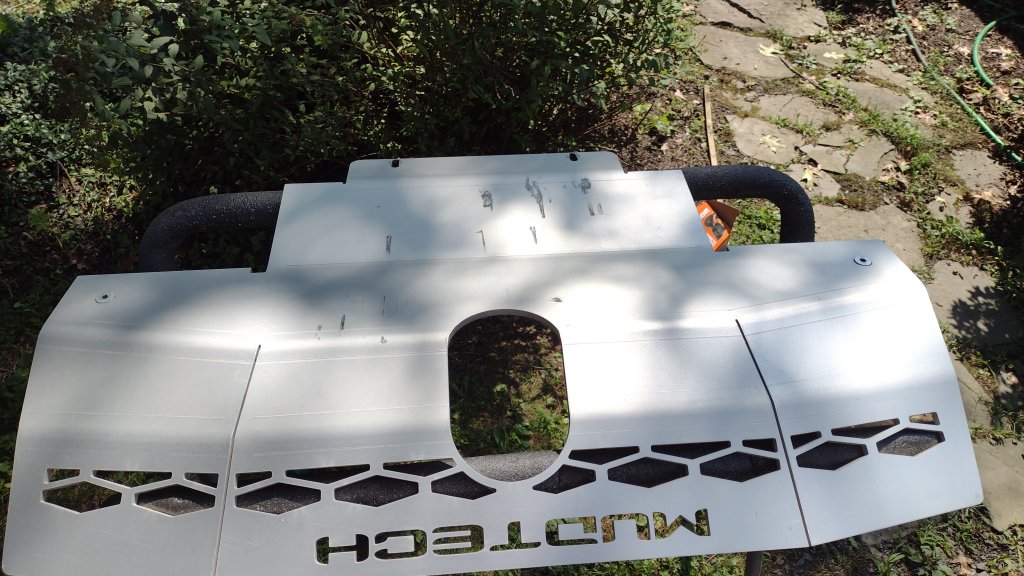

I've seen China copies of the mantech on eBay, anyone bought one? Think it said 5 mm thick. https://ebay.us/m/fgXy7Q
I've got a 5/16 aluminum mud tech one that may or may not fit the new bumper. Will be a few weeks to find out. if it doesn't fit, I'll be selling. It''s now painted....black. I'm in SE PA.
