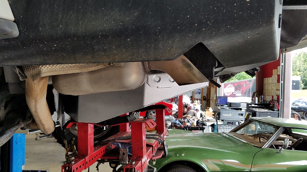

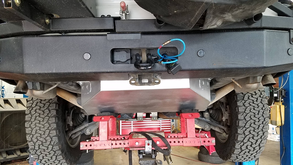

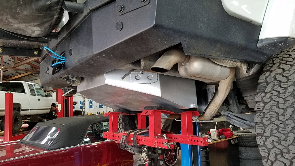

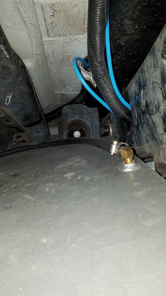

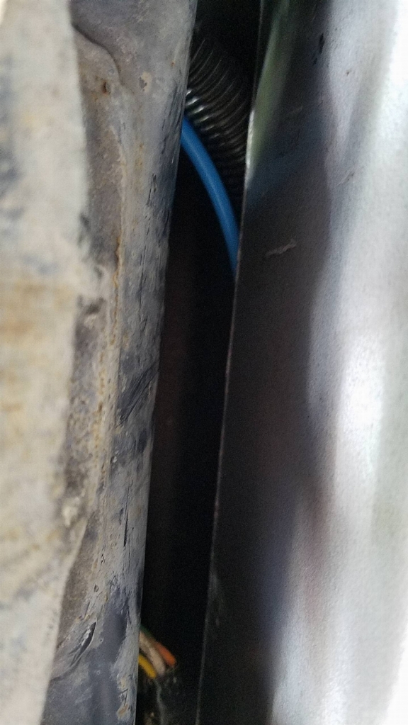

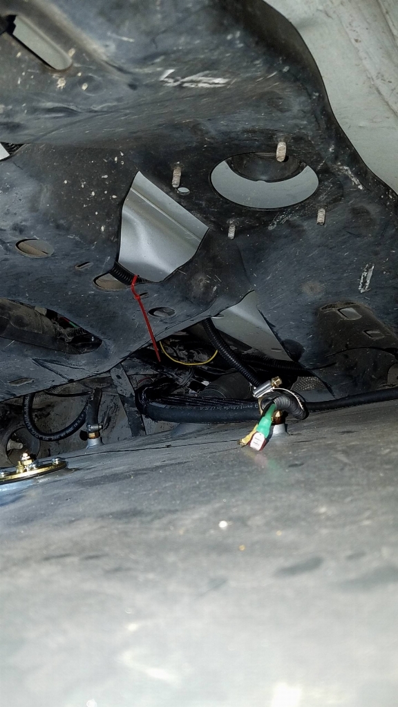

A few more images.
View across top showing routing for trailer hitch wiring, and GOE Emergency Air System plumbing.
Clearance between tank and factory rear inner bumper when tank is in place.
View across the top of the tank showing sending unit, vapor return port, and fuel output port.
Tank pretty much in place supported by axle stand.
Right hand view.
Left hand view.
