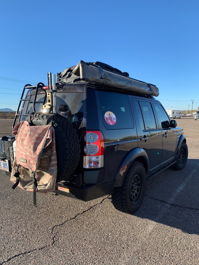

Long Range America stock the aux. fuel tank that is made in Melbourne Australia by Long Range Automotive. They also stock the Kaymar rear steel bumper with swing carrier, also made in Melbourne. Both companies produce top-quality aftermarket equipment & are family-owned businesses & been around since the 1980's.
The Kaymar rear bar is in my opinion the best of its type available anywhere. I've had mine for 2.5 years
now & I'm completely happy with it. It protects the rear of the vehicle, is all steel & mounts rear sensors. The OE camera still works fine if a single RHS carrier is fitted.
I have an aux. fuel tank made in Melbourne by Brown Davis, who have been around as long as LRA tanks.
Both brands are beautifully designed & built. For Nth. America customers Long Range America is probably
the best option as it's a "one-stop-shop". I understand that Brown Davis ship their tanks to the U.S. bu
not sure of a U.S. distributor. The U.S. prices on the LRam website seem reasonable in view of current exchange rates.
The diesel aux. tank is also suitable to use with gasoline.

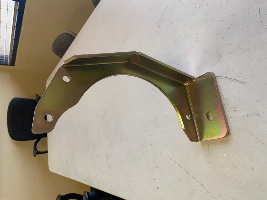

I have both the auxiliary fuel tank and the Kaymar installed on my 2013 LR4 from Long Range America (LRA). The tank is designed for diesel and will require some mods to the filler pipe so its not easy out of the box. It was additional $ to modify and install on top of the tank price. The Kaymar bumper has support brackets to the bumper wings and frame which are designed for the D4's round rear resonators in Oz but the NAS spec resonators are square so currently working with a fab shop to redesign the bracket; meanwhile the other option is to cutoff resonators or install LR3 resonators to accomodate the support brackets which keep the bumper from sagging under the swingout tire weight.
Glad to see someone has one up and running. I would bet there are still less than 10 in North America. Sounds like it might be easier to get the tank in hand now at least, without having to go to the trouble of importing it oneself.
The tank is adaptable but as you said, not for the faint of wallet
