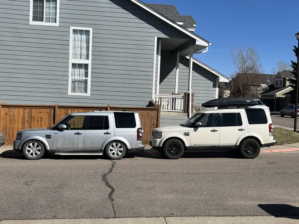

I have fitted some nice second hand Black Rhino Overland wheels with 265/65R18 Wranglers on her.
