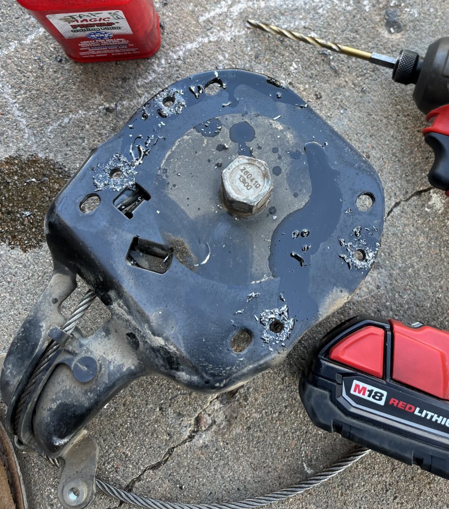

How did you open that thing? If I remember correctly it was spot welded shut.
I bought an aftermarket one off amazon and after a couple days the tire fell off, fortunately it was in the driveway not doing 70 on the freeway. The bracket at the end of the cable fell apart.
Decided to just buy the expensive one for peace of mind.
Mine looked like it was pressed in 4 spots, I simply drilled through those and wedged a flathead in to crack it open.

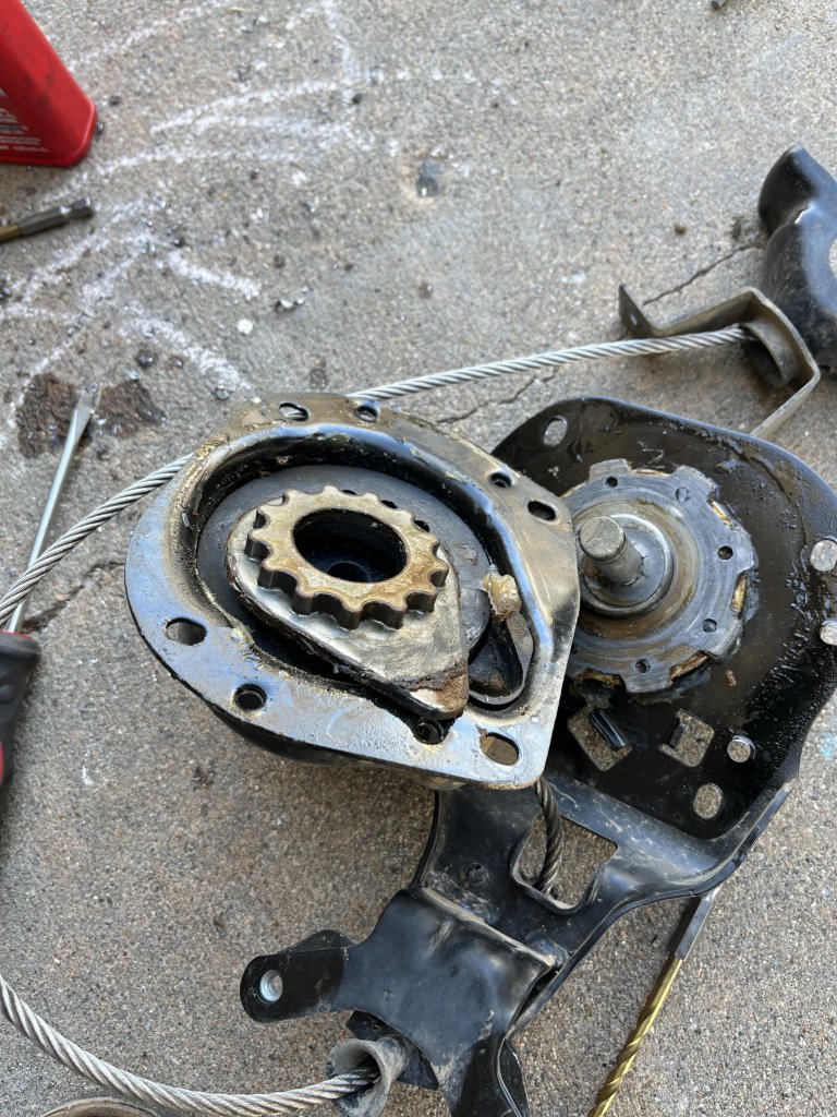

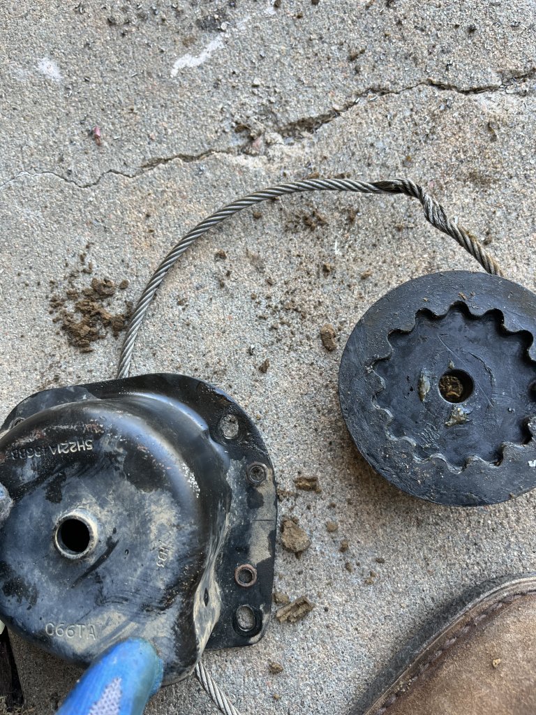

Here's the wire spool with the kink visible, note the chunks of sand that came out along with it. The spool is channeled specifically for the braided wire, I don't think there's a way to put a nylon style rope on here as it's not a winch in a traditional sense. I tried to Mcgiver it by cutting off the kinked section of wire (approx 5 inches) and tried to put it all back together but the mechanism is so worn out that it couldn't pull the spare tire up.
Could you rebuild the stock winch, maybe with synthetic winch rope?
Hopefully I have better luck with the aftermarket one, it looks to be the upgraded design.

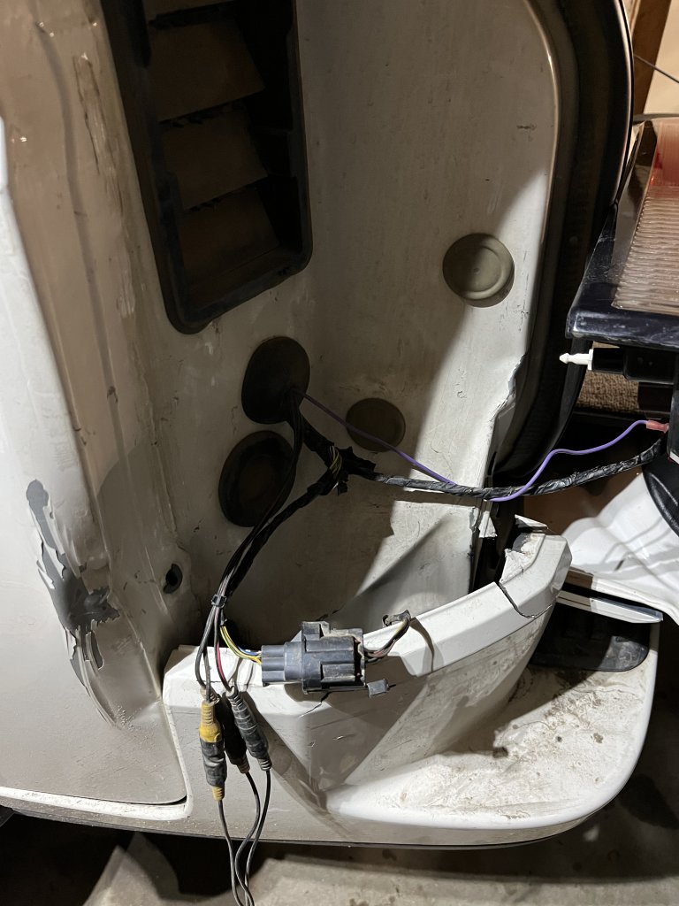

Couple of updates: The LR4 is at the paint shop getting the bumper and quarter panel fixed and painted.
Before pic:
