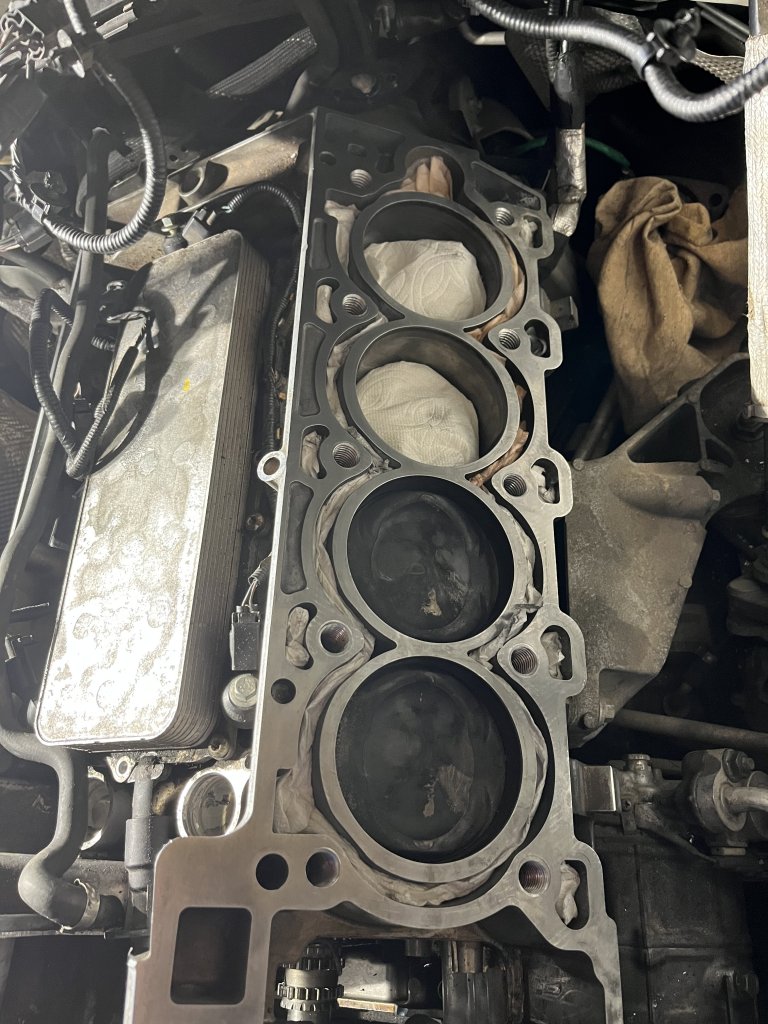

Update: Parts day!! Got most of parts today, the only thing that Merriam didn't have in stock was the crank seal. Received the timing, Headgasket, seals and headbolts.
I also spent most of the day retapping the remaining headbolt holes, I'm so happy that part is done, all in all, that probably took 15 hrs worth of my time. Some of the easier to reach ones only took 20 minutes where the hard to reach ones, mainly the lower corner ones took over an hour each.

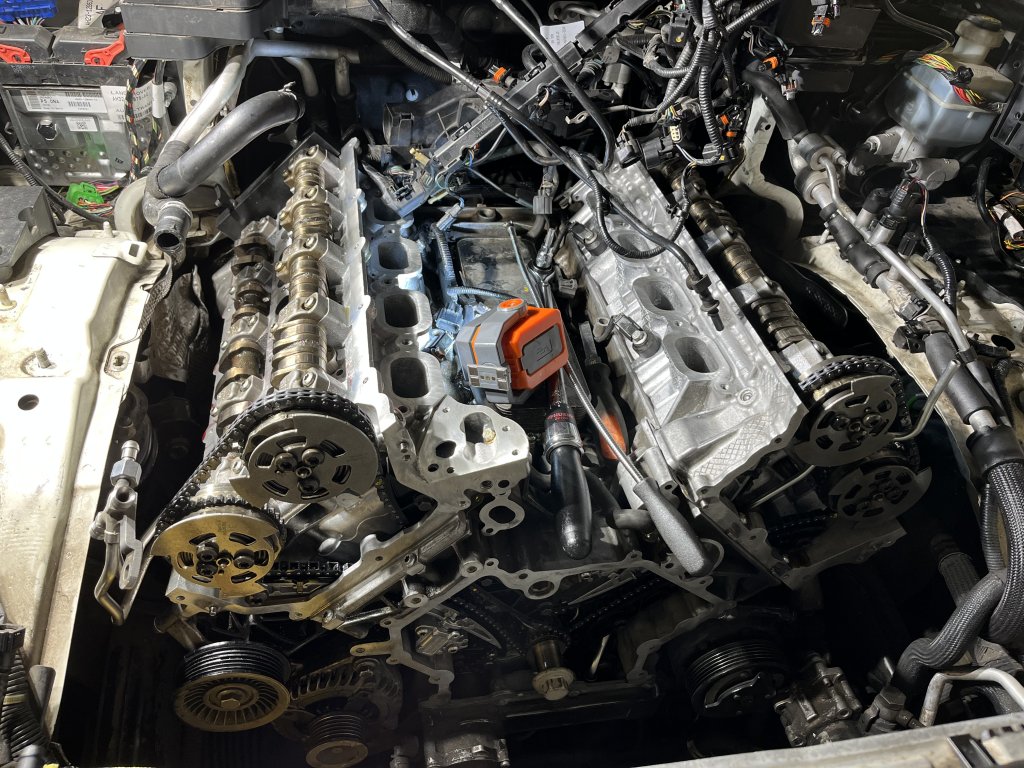

A few updates: drained the rest of the oil and cleaned both feed tubes, I didn't replace the bottom aux chain, tensioner and guide as you need to drop the oil pan for this, to drop the oil pan it looks like the motor needs to be out. However, I checked the condition on the lowest timing components and it looks to be in good shape, so I'll leave them as is.
Both heads have been put on and torqued to spec, connected the exhaust manifold and O2 sensors.
Next up will be to get the camshafts and timing components.

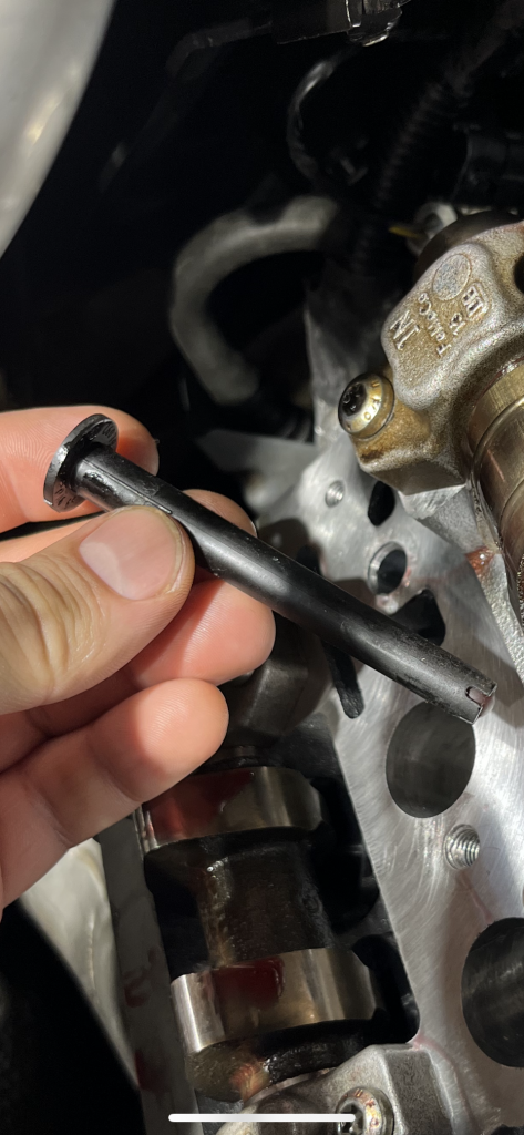

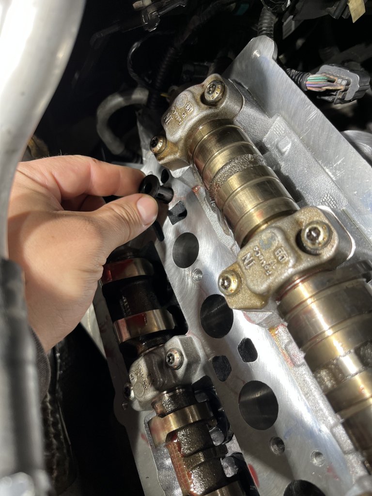

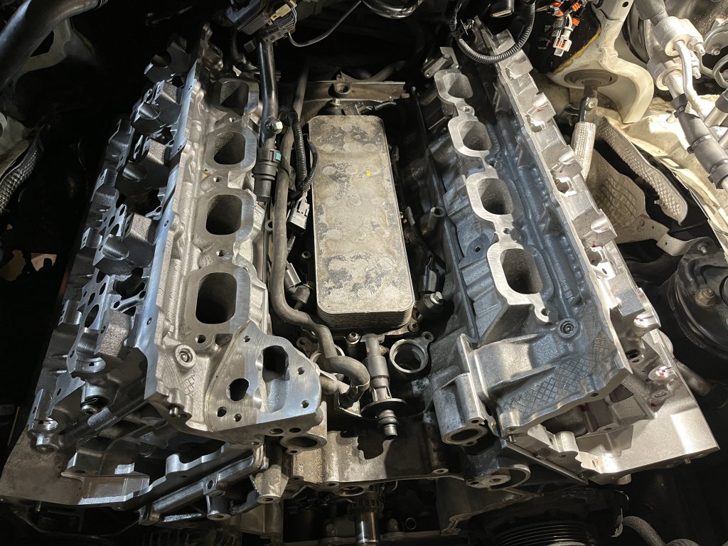

Does anyone know what these black tubes are that are inserted near the rear of both heads?
One of them came back broken from the machine shop as I had forgotten to take them out, so I'll need to replace it but they don't have part numbers and aren't visible on any parts diagrams that I've seen.

Cams and the rest of the timing components are in. All timed up. Actually had to do this twice as the first time I noticed that 3 of my cam followers on the drivers side bank only had 0.21mm of clearance, that's 0.02mm beyond the threshold, not sure it would've made that much of an impact as these followers break in/wear over time and the gap would've all but disappeared but I didn't want to risk burning valves especially since it took me a few extra hrs so I went to the local stealership LR of Denver and spent on $30 per follower (3x more then Merriam... ouch).
While I was checking the cooling components, I noticed that the rear crossover inlet was in terrible shape and the water pump (even though newer) is not OEM. LR helped me out a bit with the price: $300 for the water pump kit, $124 for the rear inlet, $71 for the front inlet and $24 for a new oil cooler tube as I kept trampling on mine while working on the inserts. All in for parts so far I'm about $1900 for all genuine parts.. this is not including tools or the insert kit.
