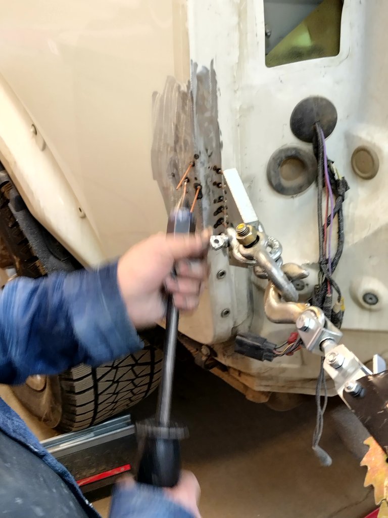

Dent pulling:

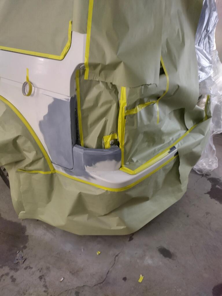

Ready for the paint booth:

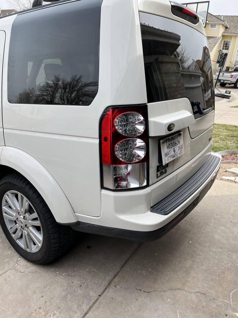

A couple more updates:

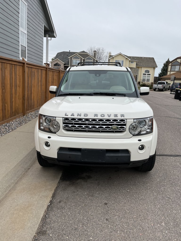

The truck is back from the body shop, the final result looks great!

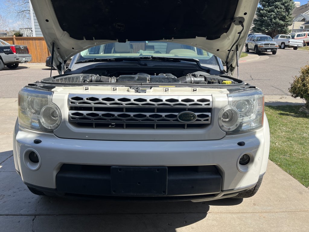

Spent some time cleaning up both headlights, these are the basic halogen version, I'd like to eventually upgrade them to the Xenon's of the same year, the face lifted ones look awesome but it doesn't make sense to spend that much money on replacing the lights, grill and bumper when these are in fantastic shape.
Before:
After:
Also, installed the OEM spare tire winch and roof rack that I picked off an LR3 and RR Sport from the junkyard.
