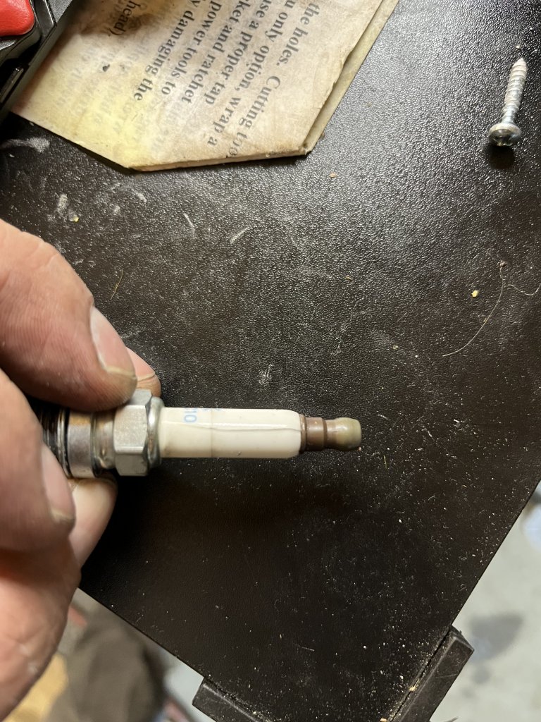

Update: Found the source of the misfire. Cracked spark plugs are no good for a clean spark! New plug put it and she runs great even with me punching it, surprised by how this things hauls a$$.

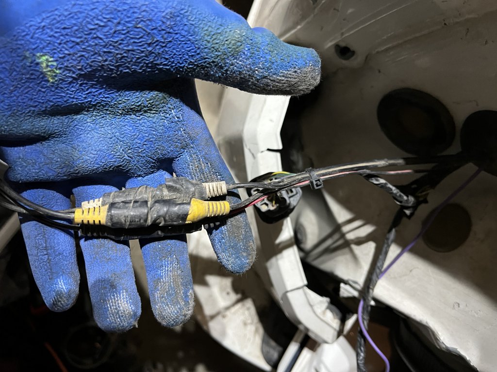

The truck is going to the body shop today to fix the cracked rear bumper and quarter panel, while investigating the damage, I noticed a couple of out of place cables coming from behind the rear left tail light, one is tapped into the tail light harness, there's also a set of RCA cables that's not plugged into anything. So odd, maybe this was used for a backup camera? The truck isn't currently equipped with one so perhaps someone did a retrofit, I was thinking of retro fitting one anyway so this wiring may be useful.
