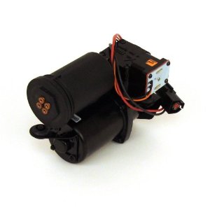

Anyone have any idea what year Expedition (Ford) Compressor works on the LR3? Does anyone have a diagram as far as what the ports on the pump are and maybe a diagram of the EAS system? Would like to setup an schrader valve to pump up the air springs in case of failure like this. It's hard to drive on the bump stops!

Here's a picture. Hopefully this works. The lines are different and the wiring.

The pic of the LR015303G shows ports on the top of the compressor that I don't see on the ford unit. I wonder if it is just the picture or what. Might be worth a trip to the ford dealer with your old compressor to visually match thinks up. It might also be worth an email or call to arnott industries to see if they can rebuild yours or they may even have something else in the works. www.arnottindustries.com

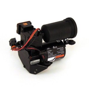

Talked to Marion @ arnott and he said they have nothing yet for the LR3. Said they are working on the bags first. He thinks the Ford pump will work but no thermal switch and different mounting locations. He is going to send me a spec. sheet on it so I can compare it to the LR3 pump. Here is a picture of there HD Expedition Pump . I will post the specs when I get them!! :albertein (and the plot thickens!)
