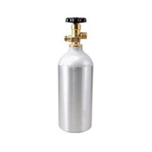

I carry a co2 bottle. 2.5# is nice and small. It has a couple thousand pounds. This should be able to be adapted to the LR3 tank if needed in a pinch.

So...Joe...how exactly is a CO2 bottle adapted?
joecool509
Nov 17, 2010
173
I haven't done, but I use a regulator with a standard tool hose. Fixed at 150# output. If you got an adjustable, you could push it up to the 215#. It would just have to be adapted to the plastic connection that enters the tank. Maybe a tee add a tee with quick disconnect? Just thinking. I haven't sized it up but should not be too difficult as most of this is off the shelf tubing. :albertein

What about the CO2 bottle itself? Can you describe it a bit...? I think I've seen them...do they look like gigantic whippet bottles?
joecool509
Nov 17, 2010
173
The regulator I have is a fixed 150# like this ...
http://eastsidecustomtruck.com/i-61362-hyperflo-fixed-regulator.html
It takes a standard quick connect hose fitting. I have a 25ft non-coil hose. 300# rating poly so it is still flexible in the cold. Those cheap plastic one can become brittle and break at low temps.

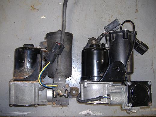

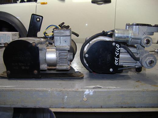

Got the Ford compressor and it is different. It may work but you will still throw codes is it has no provisions for the thermal sensor and the exaust is not compatable. Look at the pics. I broke down the Ford unit to see what went wrong with it and it seems to have a severe moisture problem. Maybe submerged in water too long or something. The cylinder is noticable smaller as well.
