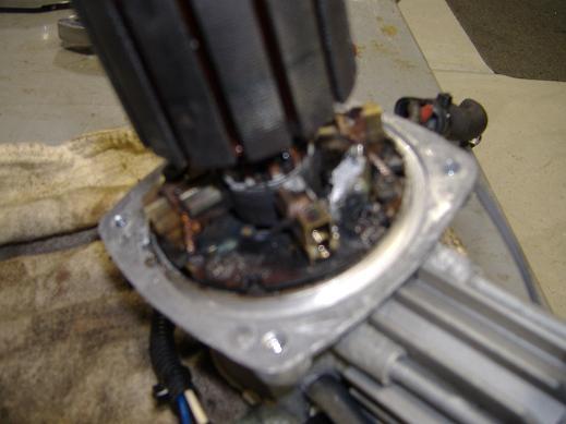

Here is a pic of my burn't out motor. Pic is blurry but you get the idea. Camera cannot seem to focus at close range.

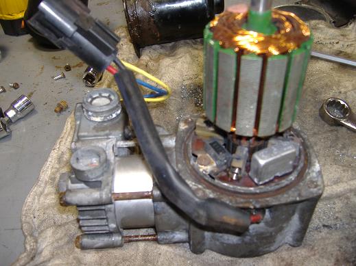

My compressor died late last year, also due to the motor burning out. I posted some pics here:
http://forums.landroverworld.org/showthread.php?t=19868
It did cross my mind to see if I could just replace the motor, but I couldn't figure out a way to detach the motor from the rest of the body. So I just chucked the whole assembly in the trash...

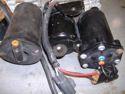

The Ford motor is smaller than the LR motor and the circuit boards are very different. The Ford does not use a rear bearing to support the rear of the rotor like LR does either. they seem to be completely different animals. Here is a pic of the Ford motor.

You can compare it to Hell Pies thread. He has better pictures of the LR pump
