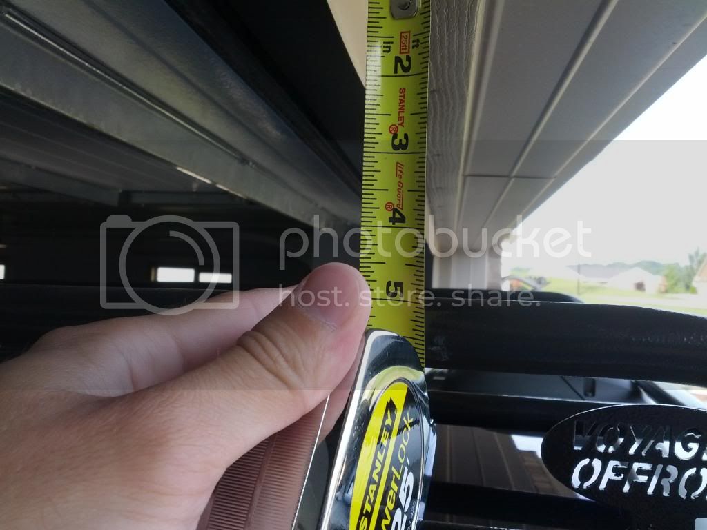

This will give you even less room. Actually based on your picture you wouldn't be able to enter your garage...

Here is access height, showing the top of the rack and the floor of the rack. I couldn't fit the spare up there today if I wanted.

yeah even with -20mm from the LLAMS I don't think it would fit. You sir need a new bumper with a swing away tire mount ;)
