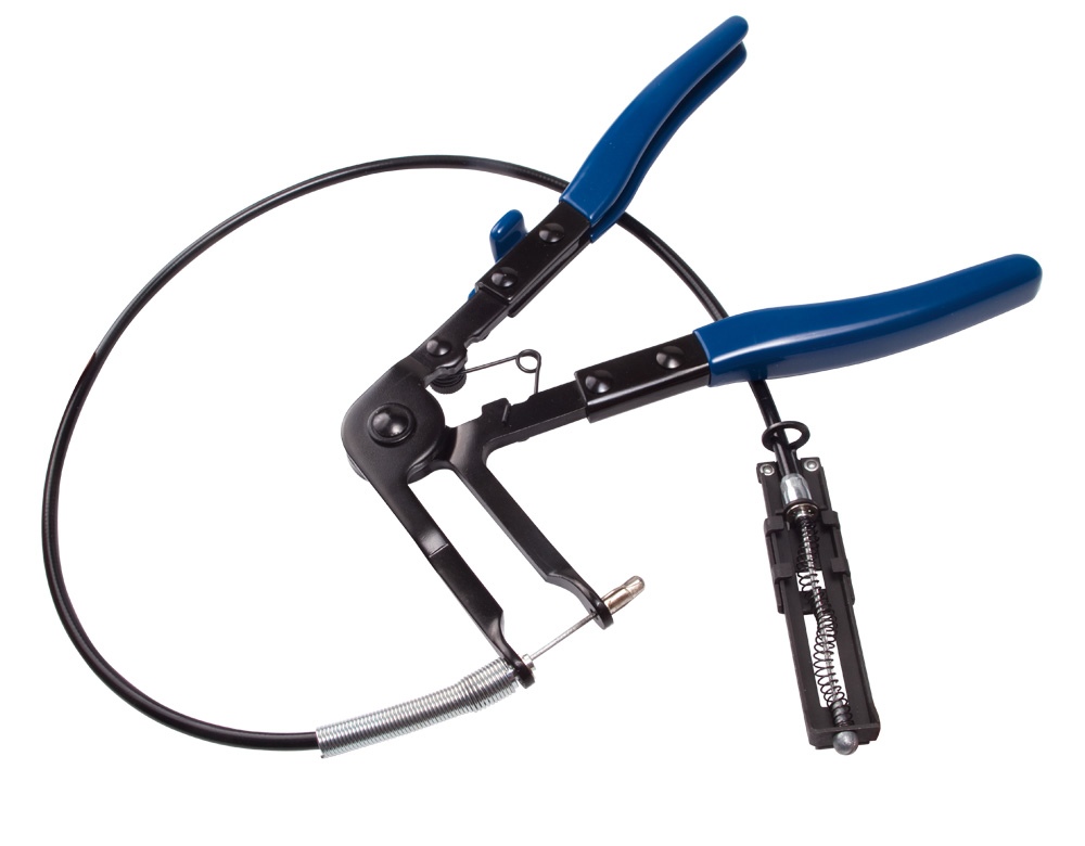

Cheap multi meter a set of 1/4" sockets and a set of 3/8" metric sockets. I would also contemplate a spring clamp plier but not neccesarry just very useful a elm wifi code reader Good jack and stands oil catch pan and some brake kleen

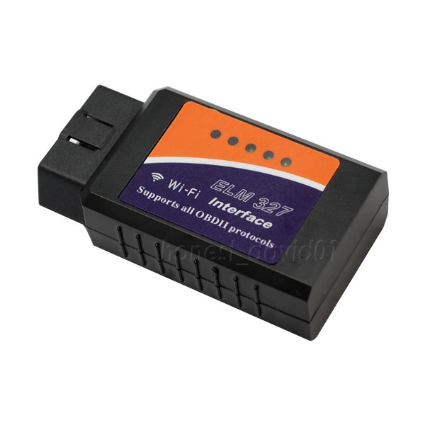

interesting about the elm wifi code reader. will look into it. is there any specific model? and can you only read info, or make changes to the car as well?
waspjr123
Dec 25, 2013
73
Its strictly a reader but it gives code info and can stream real time info it can go into the engine ecu and tcu it cost like 20.00
waspjr123
Dec 25, 2013
73
This is the one i have and it works on all types from my f350 diesel to my audi
